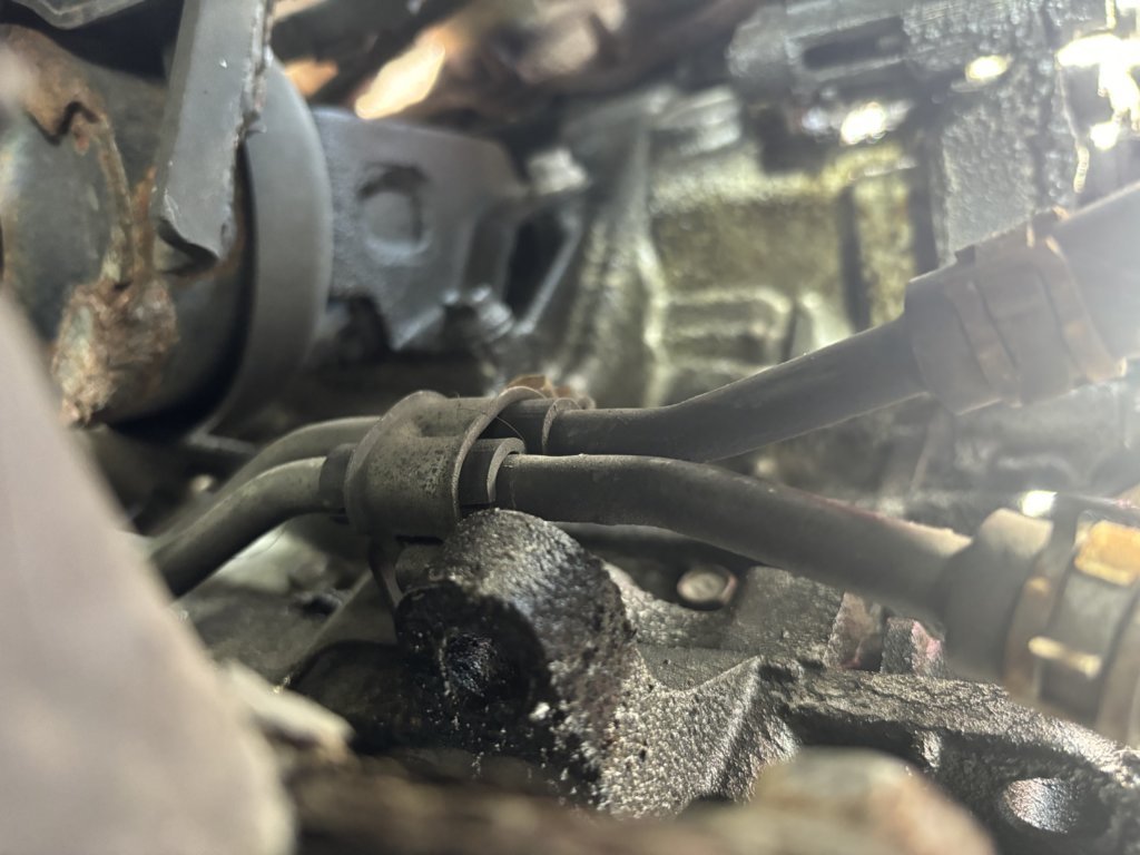

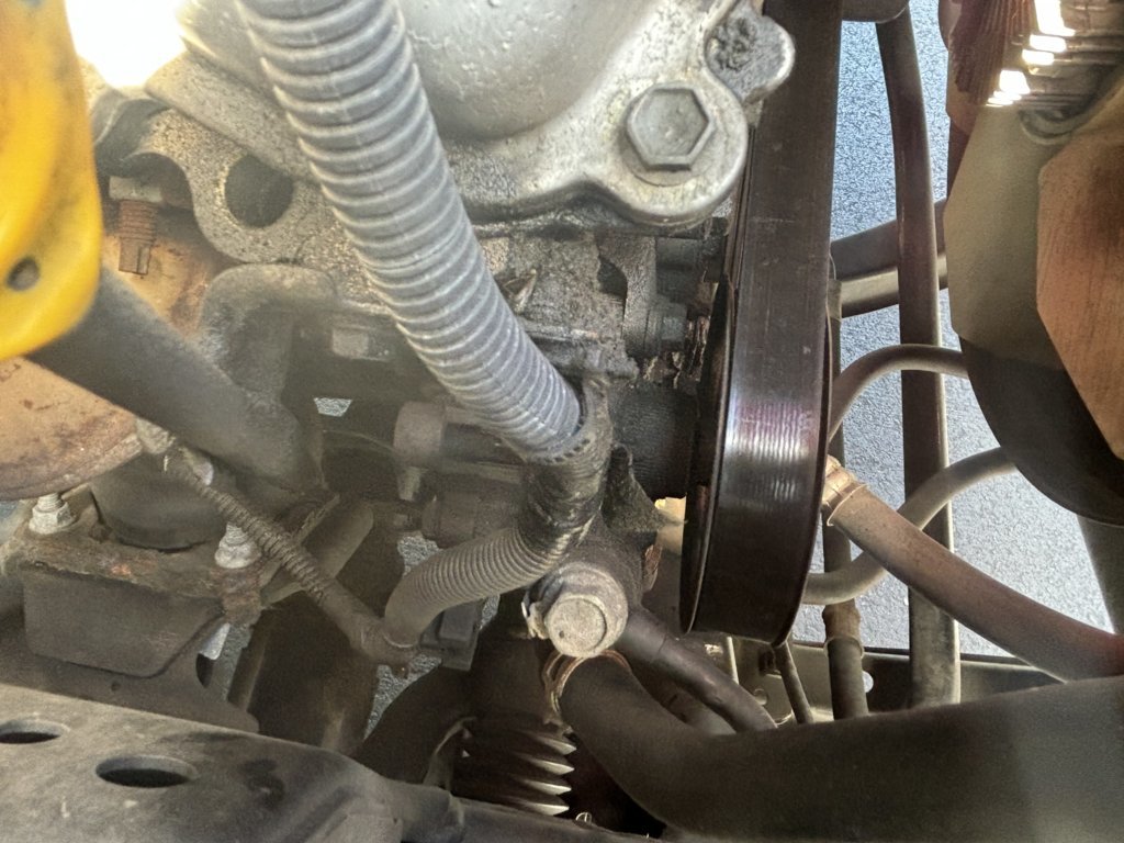

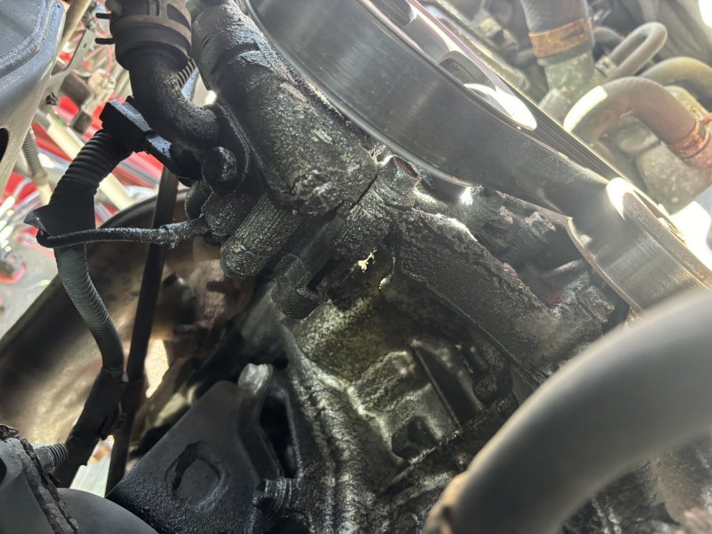

    My 09 Tacoma has been leaking oil since 105,000 miles in 2017. Now I have 205,000 miles but nothing is leaking on the ground. My mechanic said no big deal mostly all V6 tacos leak around the timing chain area. The dealer in 2017 wanted to charge me $2300 to fix the leak I declined.
    If it's not broken don't fix it. Any thoughts would be gladly appreciated. Thank you all.

    Pictures of said leak…

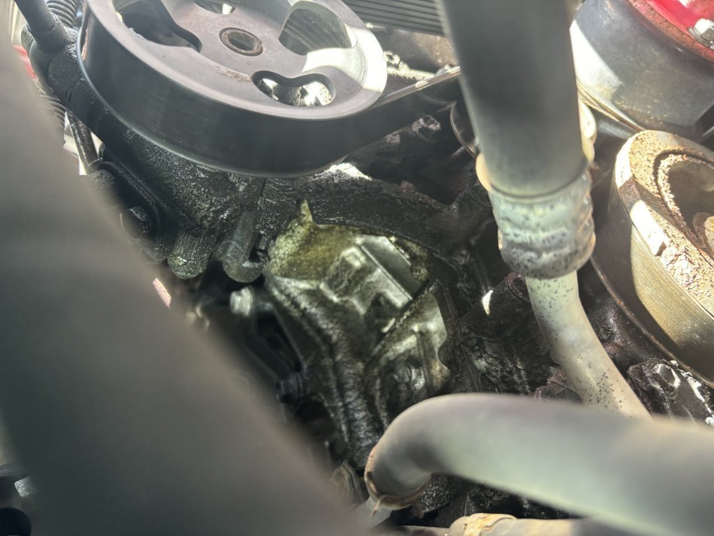

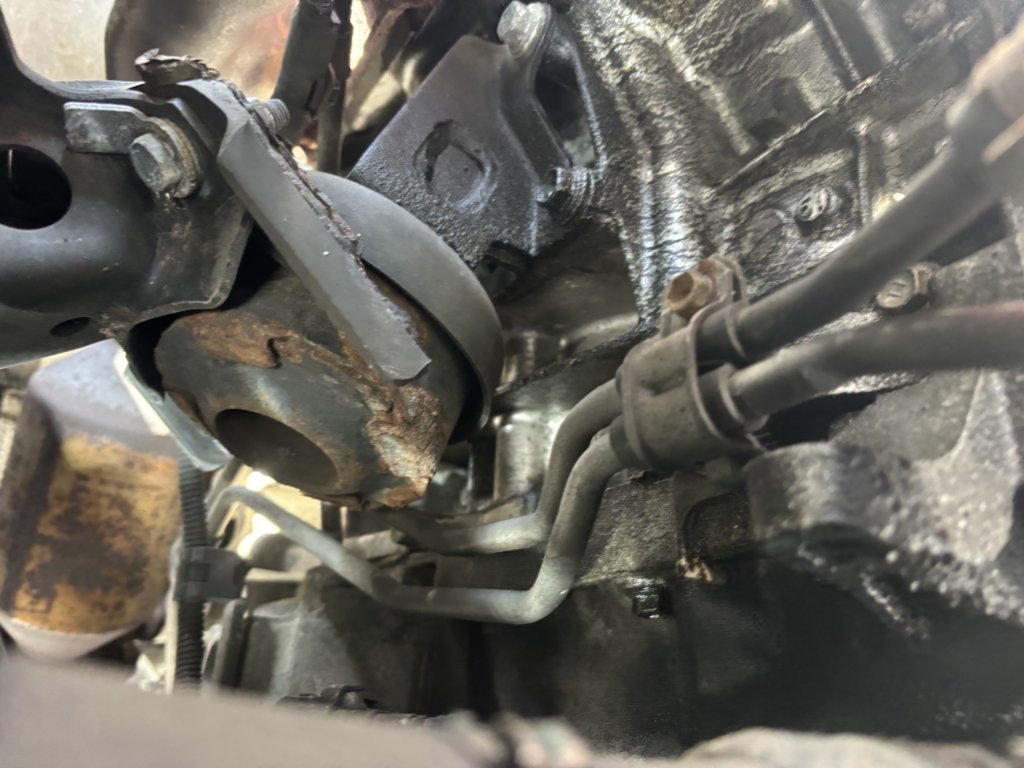

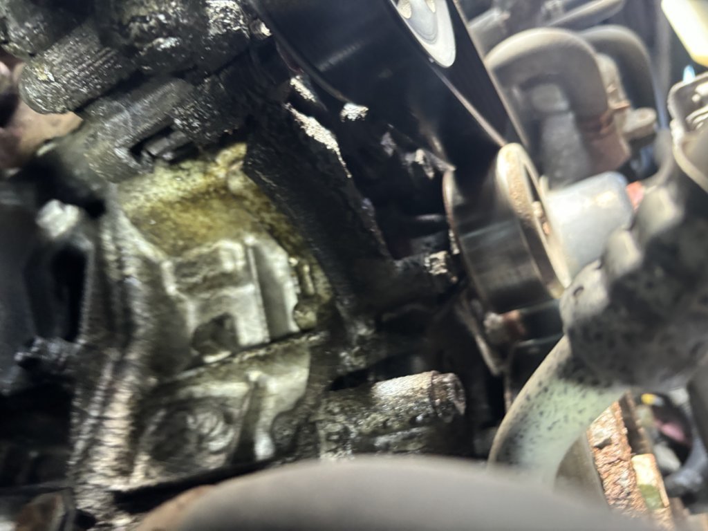

    I got more pictures,I don’t wanna drive everybody crazy. Any thoughts will be gladly appreciate it. I’m going to the mechanic tomorrow. He’s gonna do the transmission flush/ drain and fill transfer case and front & rear diff. I had the trans drain/flushed at 107m,125m,173m now at 205,000 miles.

    Supposedly the inspection cover leaks and people reseal it.
    I’d imagine large timing covers can leak but not until later.
    valve cover gaskets and power steering pump and/or hoses can leak at 100k on any car.
    You’d be better off doing something like that if at all, and cleaning and re evaluating.
    if you are not cleaning and re-evaluating, you are not looking for an oil leak.
    the pictures show leaking valve cover gaskets at minimum.

    Don't use a pressure washer in the engine bay, bad things will happen. Clean it up (Purple degreaser or similar and a low pressure stream from a garden hose). Look for the leak. Sprinkling flour over the area and then running for a few days will help.
    Once you find our where it is leaking from, you can decide what to do. Some leak from the inspection cover (easy fix)... some leak where the timing chain cover meets the cylinder head (expensive fix and not necessary to fix unless you're loosing a lot of oil). If it is the later, there are threads on here where guys try to fix the leak from the outside, without pulling the chain cover.
    The timing chain should last well beyond 200k miles... especially if you keep up with oil changes.... Replacing the chain should not be a maintenance item if you keep up with oil changes.
    Leaks in this area are very common. Figure out exactly where it is coming from and report back.
