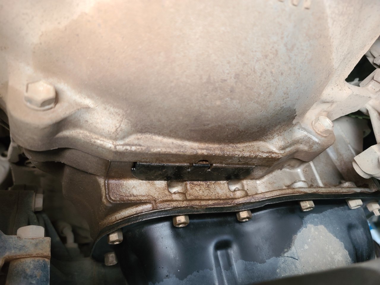

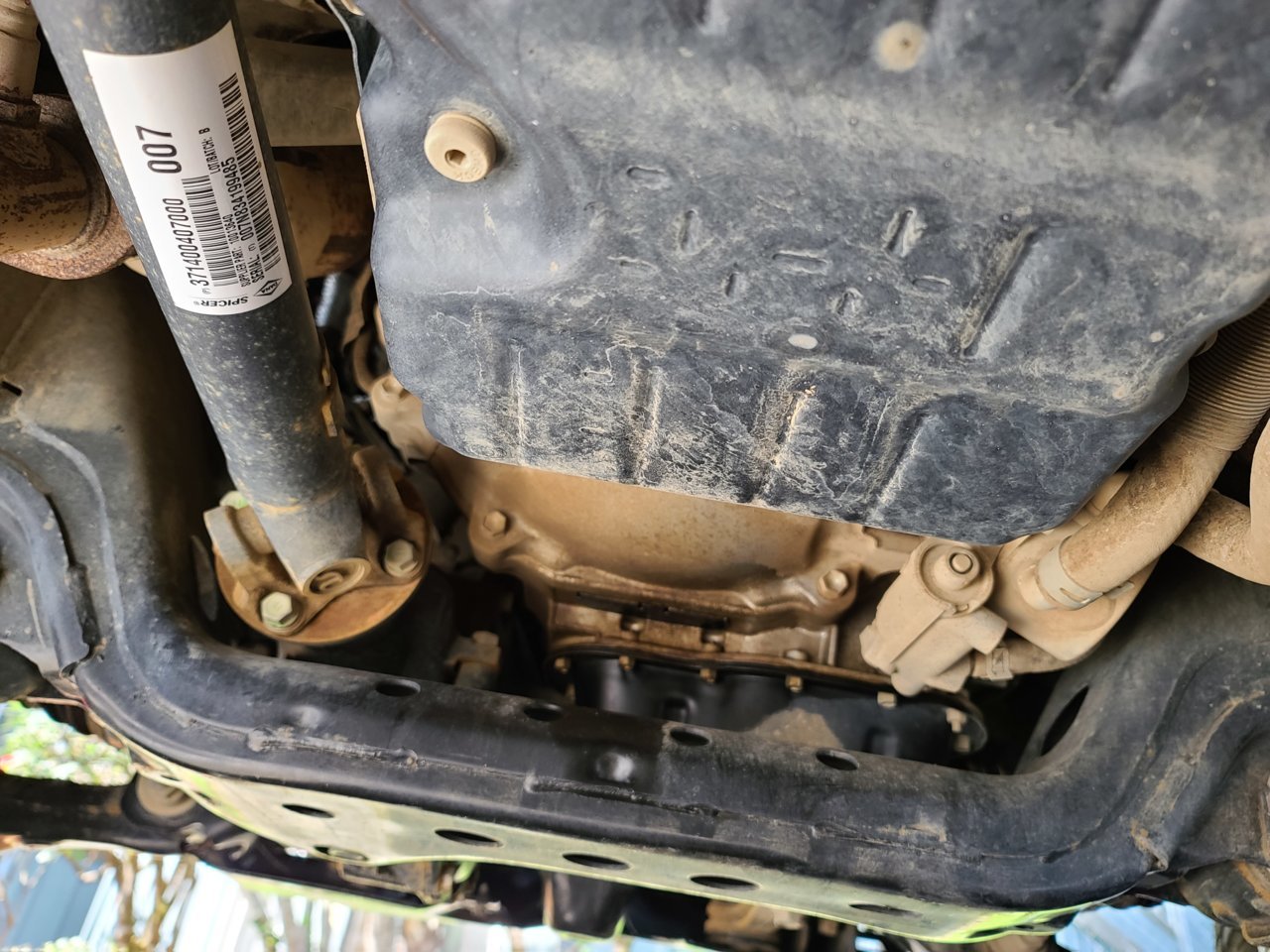

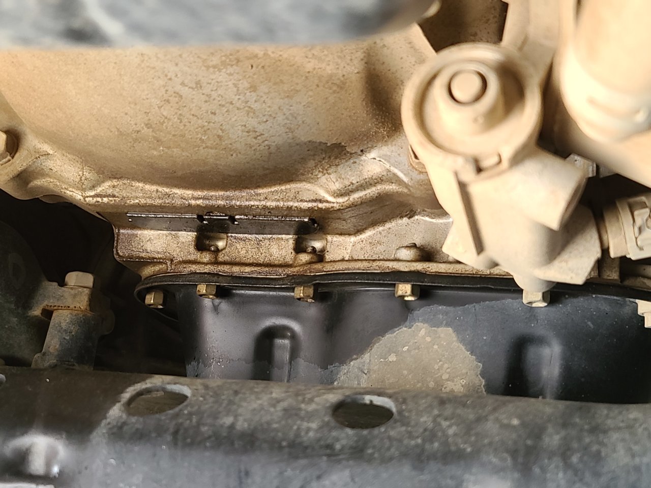

    Hey everyone
    Noticed this oil leak this am on my 19sr5 4x4, checked my oil that was changed about 4k miles ago and it was perfectly fine. Any ideas on where this leak is at, I know almost nothing about engines so any ideas are much appreciated (tried to search and can't find what I'm looking for , which I don't really know what I'm looking for)
    I see no damage to the oil pan, so have some light scraping in the lcas and supporting bars but nothing major.
    I've read people have had some types of oil leak issues, is this one of those issues. I'm gonna call to get the truck in this week and see.

    Kinda what I think, but I am super limited but this is the oil pan, correct? .

    If I'm oriented correctly, it looks like the weep hole in the bottom of the trans bell housing is the source of the fluid.
    Typically that's an indicator of a rear main seal leak.
    It would only take a teaspoon of oil to spread and make what you see, so you'll never see it on the dipstick.
    Is that the only place that's wet? Nothing on the front or sides of the engine or pan?

    Rear main seal. It happens sometimes. Not something to be super worried about but you will want to replace it asap.
    It's coming fom behind that black rectangular piece of plastic.

    Any chance it is from the "oil monkey" who changes the oil....?? IE..he spilt oil on the skid plate and it blew back and all over the oil pan.?? Hard to orient from the pics.
    Spray a degreaser on all the oil and then wash it off.....then monitor it VERY closely !!
    THat's what I'd do at this point. Good luck man.

    Looks to be coming from the bell housing.

    I hate that repair. And on a 2019 ?
    And what blasted the paint off the pan ?

    Looks like the rear main seal, sucks but yea i had it happen on my 4runner and looks similar

    If oil almost certainly the rear main seal.

    I don't see missing paint? I see a pan that's wet in some areas and dry in others.
