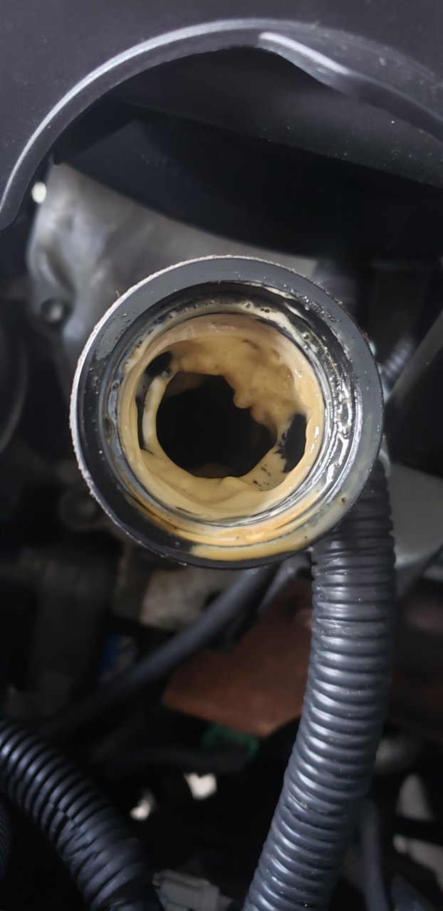

    It’s normal during winter months. It’s happened on all our trucks, nothing to worry about.

    If you're worried about it, do an oil change and if it's all milky, you have a problem. If it looks normal then it's just condensation and you have nothing to worry about.

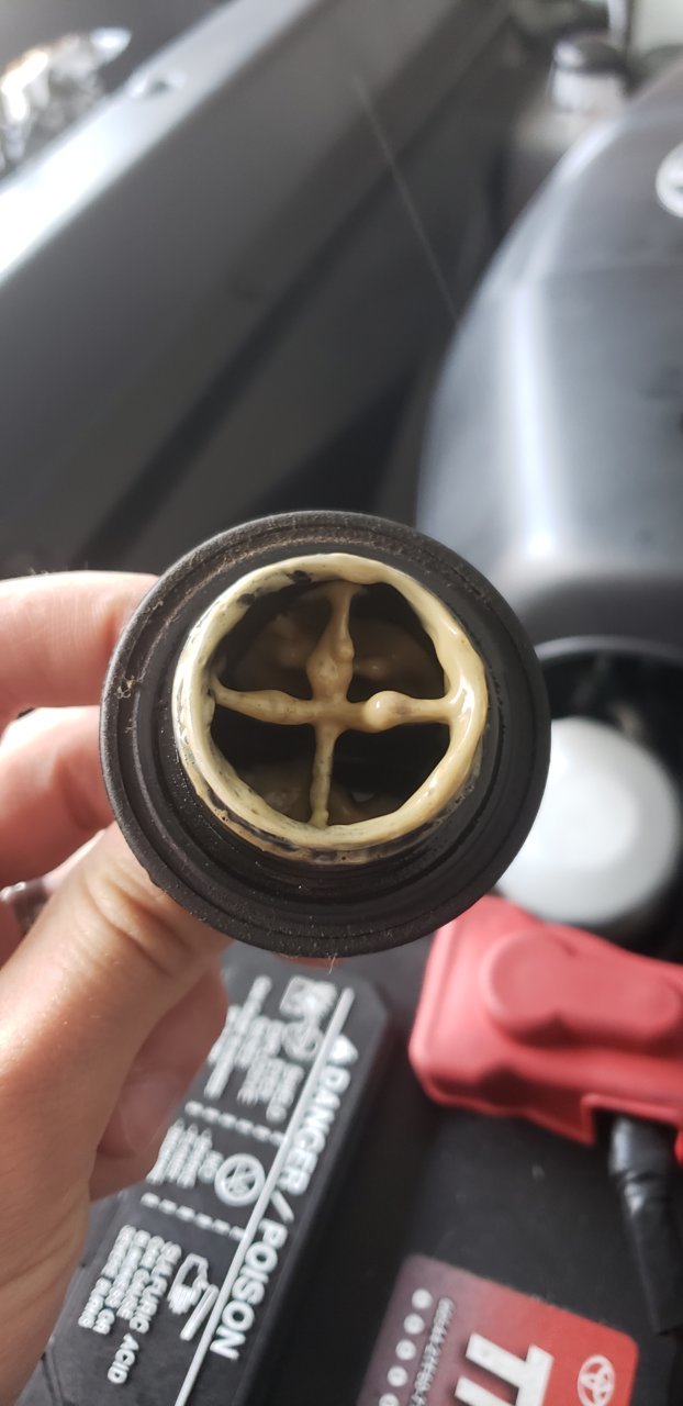

    Short trips cause this. Running any other spark plug setup besides 3 NGK and 3 Denso's causes this lmfao.

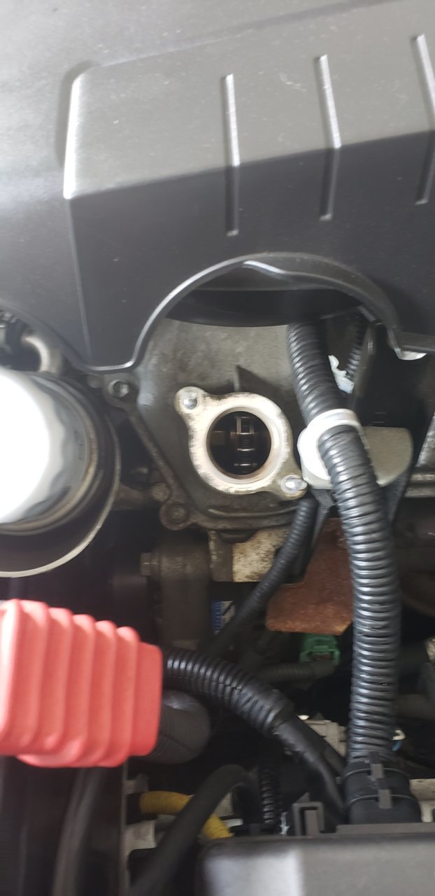

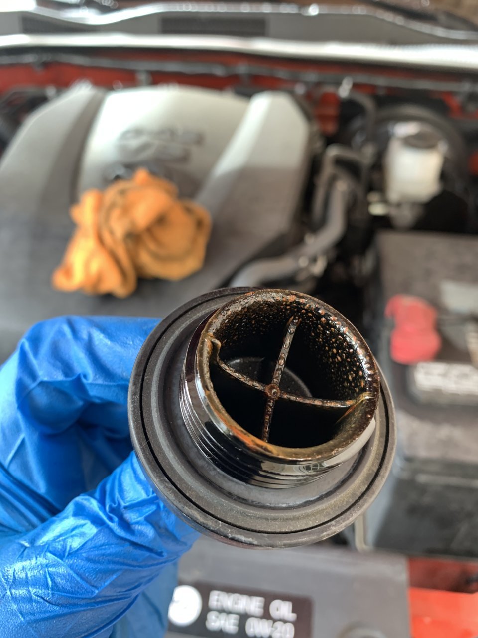

    I just took this off and when I look inside there isn't any of that. 20190408_084013.jpg 20190408_084018.jpg

    Yep, 99.9% sure you’re just dealing with condensation. Like others have said it’s fairly common especially in cold climates. Just take your truck out for more 30+ minute drives on the highway to build up enough heat in the engine to burn off residual condensation occasionally.

    Most likely there isn't a gasket failure, but don't quote me on that. This occurs because of rapid heating & cooling of the oil and block. The culprit is short trips.

    Drain your oil. If it is at all milky then you probably have a bad head gasket. If it not milky and the funky stuff is only on the filler cap and tube then it’s condensation causing it and you are fine.

    It’s completely normal for the second gen 4.0. V6! DOES NOT mean you have damage. It’s simply condensation rising up into the cap area. Short trips and cold surrounding air on the plastic filler neck is the culprit. I get this really bad in winter temps, but in summer it is gone. Just wipe it off and change oil frequently. It’ll be absolutely fine.
