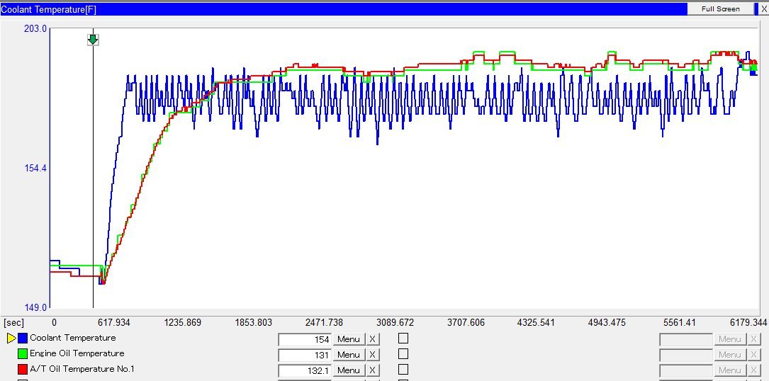

    Ya, all aircraft have them, some faa reg I'm sure. But even on car you used to get volts, oil pressure, and coolant temp. Now you just get the light that comes on to late to prevent damage alot of the time. Still though if its just calculating off of coolant temp, why is there a difference in temp between an engine with and without an oil cooler. Unless the ecm has different programing to compensate? Because coolant temp and trans temp is still the same. Don't think that would be it, and my oil temp stay the same pre an post transmission oil cooler install, which brought temps down 40 or 50 degrees. I think we are missing something.

    Coolant temp is a seesaw usually it is in upper 190 -low 200

    AT, I have a scan gauge and coolant temp is one of the PIDS I monitor well driving along with Trans temps 1,2 and EOT. I'm just not sure how it gets 280* EOT for me and 180-200* EOT temp for you, if its calculating off coolant temp because both our coolants read 180*-200* and my trans reads 160*-180*.

    I use fusion obd2 and the picture is from techstream. Both app use Toyota's PIDs.

    On my 2nd gen AT with tow package, my app allowed me to output the data points, and yes saw a significant increase while sitting at a stoplight, then a rapid cooling once moving. When towing a 6x12 cargo trailer (empty, 65 mph) from Tucson to Phx, the watched the temps rise to 210 AT and 220 coolant, then bumped down to 4th and watched them both drop precipitously into the 195 to 200 range. I concur, AT with lockup vs slipping creates huge temp differences. I can upload the file or image of the graph if someone wants. Haven't done the same with my MT 3rd gen.
