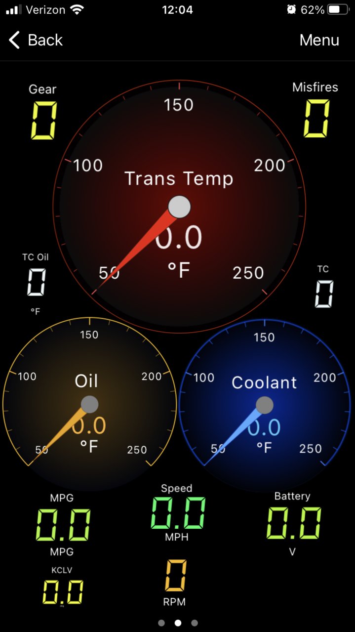

    what is what in my gauges…my oil temp stays at 194 as well and will fluctuate up to 201 or so during towing. I’ve never had any temps of any fluids get above 233
    screenshot is just to show what I look at when truck is on

    there is no oil temp sensor

    so you are saying that “Oil” is some other oil? Coolant is under a separate option when I add the gauge, and “Oil” came from a unique option as well

    it uses an algorithm to estimate the oil temp. use an infrared thermometer on the oil if you want an accurate measurement.
    like i said, there is no oil temp. sensor in the engine.
