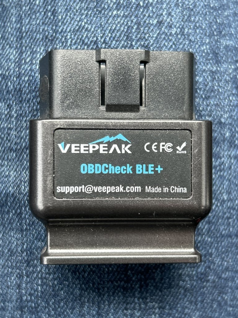

    Hey bro. What OBF reader is that ? I have the Blue Driver and it does not support oil temp. Thanks

    Veepeak

    Hey.can i ask what app your using ? Just tryed 2 apps still getting pid no supported from vehicle. Thanks

    The pid isn't supported because there's no oil temp sensor on the engine
    Some software will throw up a guess on a pid just to make you feel all warm and fuzzy, and some won't
    Again, there is literally, actually, for real, no oil temp sensor on these trucks. A scan tool can't magically stick a temp probe in a oil pan. It doesn't exist
    We see this all the time with guys talking about "catalyst temperature" .. there aren't any exhaust temperature sensors of any kind plugged into the exhaust stream. That's a diesel thing.
