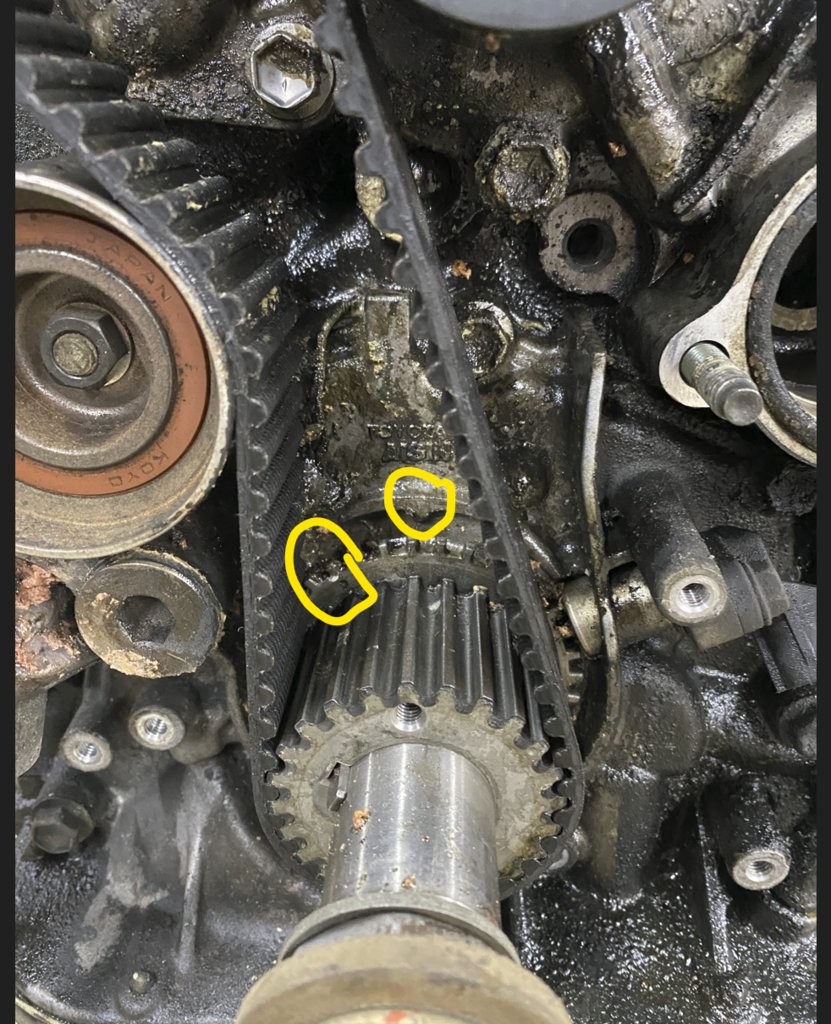

    Alright... Stopped by the dealer today and ordered: cam seals, crank seals, rear main, oil pump o-ring, dipstick o-ring, and oil cooler gaskets. I popped off the crank pulley this evening (used the 2x4 method and worked perfect) and found that the timing belt is off by multiple teeth. Is it as simple as disassembling and realigning the crank to the correct position? I've only done a few belts and everything lined up correctly before removal. Don't want to over/under think the process.

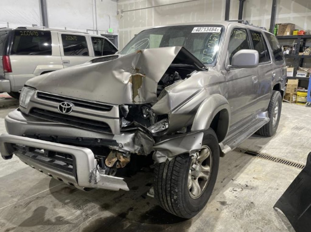

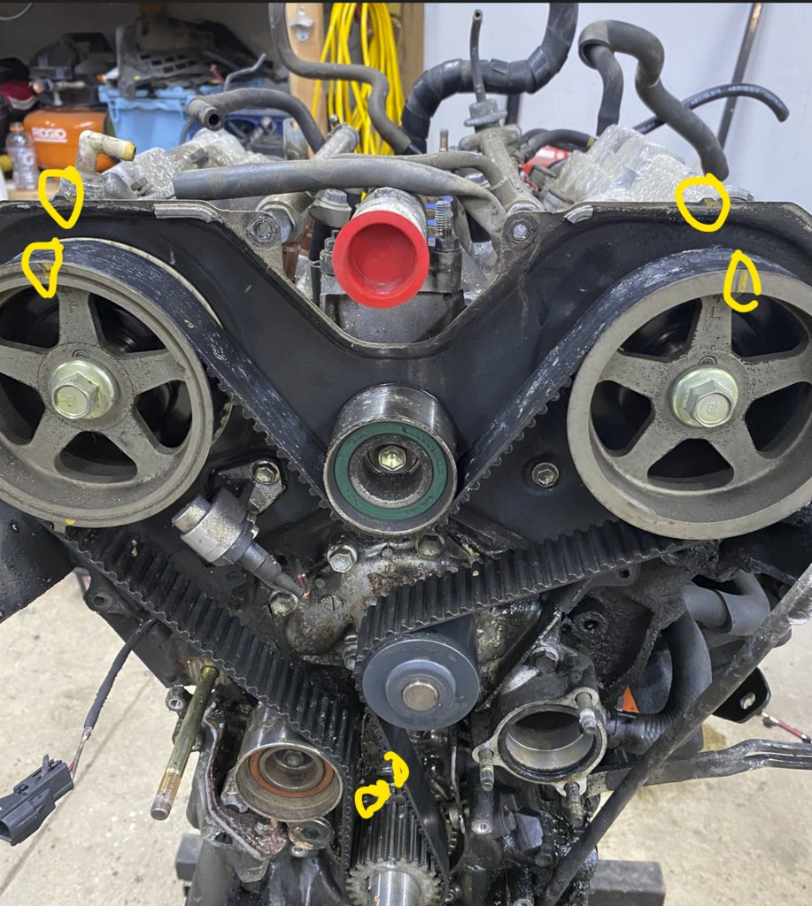

    I believe that only applies to the marks on the timing belt itself correct? I am referring to the mark on the crank (dot) lined up with the mark on the oil pump and the cam gears to the notches on the rear cam cover. All should be in a 12 o'clock position correct? Currently when the cams are lined up 12 o'clock the timing gear is 11 o'clock ish. Supposedly the truck ran and drove (totaled into a pole by the pics) before it was pulled. And yes, new timing kit and t-stat just ordered.

    Camshaft Pulley marks and oil pump body, yes
    Pole meet 4runner, damn
    The marks on belt won't realign but the marks you have circled will if timed correctly.
