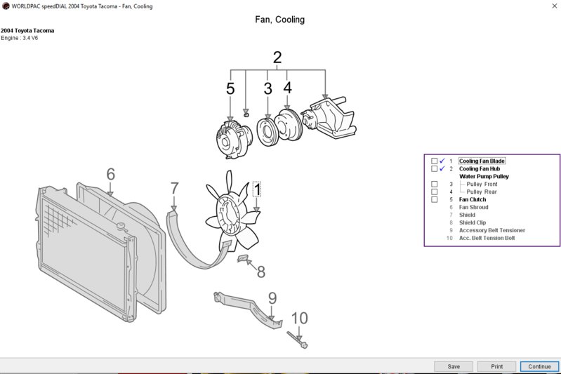

    ok im sorry, that isn't all. i forgot about at least the fan shroud. here's a parts diagram. so, unless the OP removed #2 entirely, all you will need is a new clutch and shroud. luckily you can buy everything but the shroud from Carquest, Advance auto parts, or anyone that supplies worldpac parts. theyre nationwide.

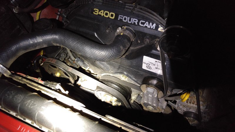

    Thanks so much for your help!! That diagram really helps to explain the way it works and what I need. One last question for you, I'm fairly positive that according to that diagram (and based on the attached pic of my motor) that I have the #2 components (hub and water pump pulley) so I would only need the shroud and clutch fan right?
    Thanks again for taking time to comment on this, it's really helping me out

    Just realized the light doesn't hit it quite right lol but it looked like it was there from what I could see under the hood.

    Seems like your on the right track! Now, check on the front of the pulley to see if the bolts are still there. if they are, you can just loosen the belts, slap a clutch and blade on, and be on your way! just need to get that shroud and youre golden.

    oh wait, the bracket has studs. the bolts WILL still be there, you just need to loosen the nuts and throw the clutch on!
