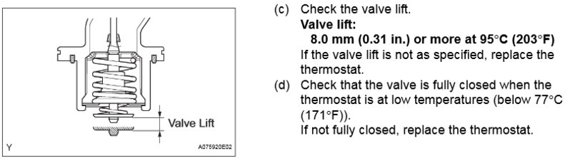

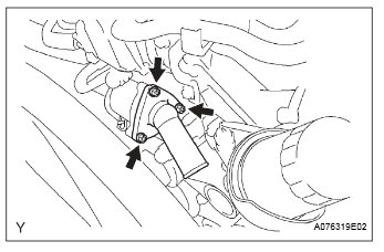

    It is built into housing, so he won't be able to do it, But Thermostat is right up there so its easy to remove and test in the boiling water pot (just don't let your wife see it, she will make you toss a pot and get new one in a fear of poisoning everybody.):D
    foampile[OP] and D50boy[QUOTED] like this.
  12. May 19, 2015 at 11:35 AM
    #52
    D50boy
    D50boy Well-Known Member
    May 15, 2015
    #155317
    59
    Kenneth
    Texas
    Ah, then yea. Take the whole housing out and sit it in really hot water. The bottom should extend out which opens it (to let the coolant through). If it doesn't open at least 8mm, replace it with a new one.
    foampile[OP] likes this.
