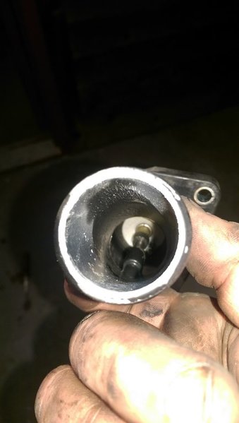

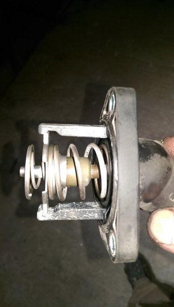

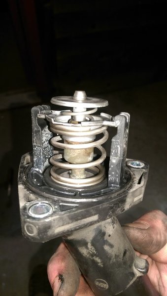

    Here is the thermostat. I have not done the boiling water test yet.

    I would consider a replacement of the thermostat at this point- it's out and if things got that bad, it may be damaged at this time. If you bench test it and it "seems" ok, and you reinstall it only to find the actual cause of the overheat and resolve that, you may come to wish you'd replaced the thermostat anyhow.
    As I'm sure you know, there will be a cause for all of this, but then collateral damage occurs and is sometimes not detected- part "A" caused the overheat and over time while driving and using the vehicle, the excessive heat/boiling water/pressure/temp changes will cause your hoses, thermostat, radiator cap, etc... to experience damage that may not be readily apparent, and for the most part, they are not the expensive parts to watch out for. If you're this far along, it's something I'd consider doing.

    Is there a way to pop the thermostat out of the housing without destroying the whole thing? If so, you could run it like that to see if that it takes care of the issue.
    Or if it's cheap enough, replace it anyway while it's out. I still think that's all you have wrong besides the torn up belt.

    Second, it's a pretty simple system. Either the thermostat isn't opening to allow coolant to be cycled through the engine. The water pump isn't cycling the coolant or the heat exchanger isn't doing the job.
    You've got the thermostat out, but a new one and replace it.
