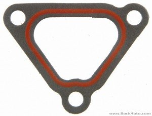

    Do I need a water outlet gasket, which is advertised at RockAuto? It looks like a seal between the thermostat housing and the socket it goes into (what is that called and where does it lead to, just curious?). The only thing that was there when I took it apart last night was an O ring (and it looked kindof worn out). Is it possible that I need that outlet gasket and mine was just completely gone, causing leaks? Here is a picture from RockAuto:

    I'm not sure what that socket would actually be called, but it's basically the flow inlet for the coolant for the engine. Once the thermostat opens it lets more coolant flow through the coolant passages in the block so the heat can be removed.
    I can't see how the gasket would be completely gone, usually you can still find shreds or remains of a gasket well after it's broken down. I'd just replace the O-ring myself but someone with more experience on the Tacoma might be able to comment on where that gasket actually goes.
    If you had a leak you should be able to tell. Do you change your own oil? Did you ever notice a sweet smell when you were changing the oil? Usually when you have a leak there you can smell it and see the residue.

    Yes, never had a coolant leak before last Sunday. I think it was leaking out of the water pump weep hole.
