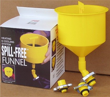

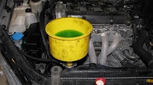

    The tech used a specific funnel designed to attach onto the radiator in place of the cap. They'd fill the system and keep the funnel about half full. Then they'd "burp" the car- the bubbles have to go all the way up and out of the funnel. This is easier than trying to keep the system full by standing there an adding coolant as it's spewing bubbles out of the open radiator cap.
    They come with a long-stemmed stopper. When done burping and no more bubbles come out, put the stopper into the bottom of the funnel and lift out- dump the remaining coolant from the funnel into the overflow.

    They come with adapters to fit the radiators of many different cars.

    Ooh I could use one of those funnels!

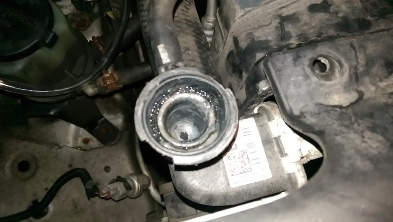

    I have installed a new water pump and a thermostat but haven't run the engine yet.
    I discovered that, when this first happened, when the coolant was steaming out of both the rad cap and the resi tank, and whan I opened the rad cap when it cooled down, there was an inner gasket at the rad opening where it meets the cap that was melted down and in pieces and I had to throw it away. It was not a part of the cap. Here is a picture of what that opening looks like.
    Can anyone confirm that I am missing a gasket there ?

    I don't think so. But your radiator looks different. All gaskets are on the cap.
    Is that original radiator?

    Strange I have 07 too and that whole piece is plastic on mine but yours look metal ( or is it just a picture?)
    Anyway no gaskets on that part, there are two gaskets on the cap. If you found pieces of gasket, I suggest getting new radiator cap.

    Done already
