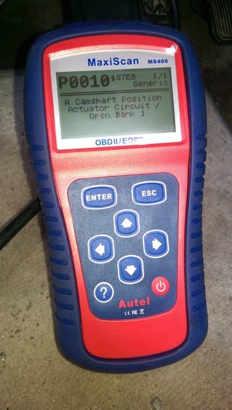

    I replaced my oil and filter but, before putting proper coolant in, I wanted to actually drive it a little with just tap water to see if it will overheat again. The first thing I noticed, when I turned the truck on, was that the check engine light went back on. Since I was at home, I had my OBDII tester handy and got that the code was P0010: Camshaft Position 'A' Actuator Circuit Bank 1. I also looked in the code history and it showed that recently only that one code was showing so I guess that's the one from the beginning of the trouble two weeks ago, referenced in the OP.
    I decided to drive it anyway. So took the GF on a small errand road trip, we drove about 50 mi. The engine didn't overheat, however, at one point, just after I parked in one of the pit stops, I popped the hood and noticed that the spillover resi coolant tank was indeed boiling but very small bubbles and assumed that was the case because I had just tap water in the system for testing and not proper coolant. Other than that, everything went fine, the truck drove fine, no funny noise or anything.
    The remaining mystery is, how did the malfunction that cause that OBDII code cause the truck to overheat because the overheating happened some 30 min after the code showed? Or could they be unrelated.codeP0010.jpg

    The reservoir tank was likely not boiling, those bubbles were probably just air that was still trapped in the system escaping into the reservoir tank.
    I think that code is caused when the Oil Control Valve gets jammed open with gunk or just plain old fails which causes the variable valve timing to not function. I'm not sure how that could be related to the overheating. I also won't be much help on where the OCV is on the vehicle or the diagnostic to check it. I'm sure someone else here knows that though :thumbsup:

    There was a lot of gunk around the bottom of the engine block, especially on the driver's side because I think the left (or both) of my valve cover gaskets are leaking a little. I actually cleaned it with a small wire brush there was a lot it black gunk buildup. Then I soaked everything in Simple Green with a kitchen sponge and rinsed it with a garden hose multiple times. I will be getting replacement valve cover gaskets.
    I tried looking on RockAuto for OCV but couldn't find any. Google did return this.

    That is the valve I'm talking about. However I have never replaced one so I don't know what the failure rate is like or how to diagnose whether the part is the real issue.

    do you think the P0010 code could be related to leaking head gaskets as well ?

    No, Not related. That code points to the timing via the Oil Control Valve or OCV Filter.
