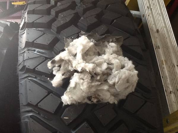

    well i might have found out what was causing my engine pinging & lack of power uphill today
    I replaced my spark plugs denso iridium and replaced my air filter with a K&N, but in the process of getting to my spark plugs I take off the intake tub to find it blocked up with an old rodents nest!!!!
    it was so compacted in the tube my old air filter was clean as a whistle.
    must have been like this from the previous owner, i have 31k miles on the truck now and bought it earlier this year with 25k miles
    I couldnt believe it wasnt running worse than it was. this is what was in there some shreaded cotton like stuff from like inside a pillow and a couple dryer sheets

    needless to say i am sure that wasn't helping anything, but an intake restriction of any kind will not cause pinging.

    Yeah it was a cpo vehicle too, so much for their inspection, needless to say after using 93 octane, new plugs and filter, my truck is running great, more power, no pinging or knocking, my next fill up I will go back to 87 to see what happens
