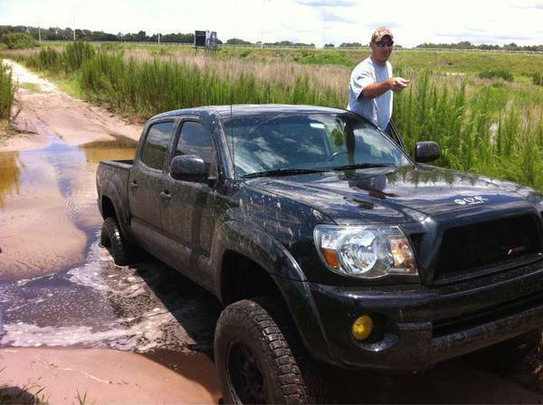

    From Sunday.

    Do not drive fast. Your truck will create a bow wave at the right speeds lessening your chances of screwing up something.
    The cleaner the water the better (don't be the last guy through the hole).
    Exactly what you don't want to do. If your spraying mud on your hood your spraying the crap out of your alternator and starter.
