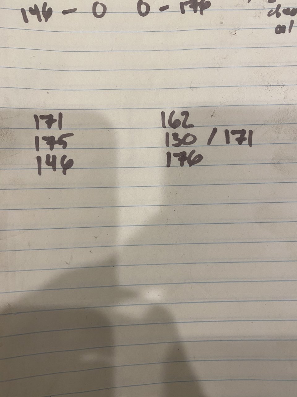

    Hello Tacoma enthusiasts. Recently I bought on auction a 2003 Tacoma with 264k miles. I torn into this thing to do some much needed maintenance. The valve cover gaskets leaks an incredible amount of oil and I was going to go right to replacing those while I have the front end apart to repair some cosmetic damage. I opened the intake and noticed some oil which immediately got me thinking about what else I needed to check. I ended up doing some compression testing and these are the results I found. The piston that measures 130 was improved by adding some oil to the cylinder. So now my question is, do I dive into an engine rebuild or does anyone suggest that this be a reasonable condition to drive until it starts blowing smoke? And when that might be by estimate. (Currently runs great, no smoke) I also have not adjusted the valves yet and I’m hoping that may improve the compression ever so slightly but I don’t know how far I want to go without a game plan. Thanks guys all opinions are welcome but hoping there’s some reasonable mechanics with knowledge of engine rebuilds, maybe even on this gen of Tacoma....

    130 isn't awful and if its not smoking I wouldn't personally do a bottom end rebuild unless it was pluming smoke.
    The low compression could be rings/ring lands or cylinder bore but the problem lies with the cost to machine all parts and cost to replace pistons and rings along with all associated parts.
    When its running, try removing the oil cap and see if you hear lots of combustion or if smoke comes out.
    I'd start personally by doing a hot injection or seafoam clean. This can loosen carbon off the ring lands and possibly restore compression off the valves etc.

    If its running fine i wouldn't worry about it too much. Just keep checking the oil and see how the level changes over time, that'll help determine if you need to dive into the motor
