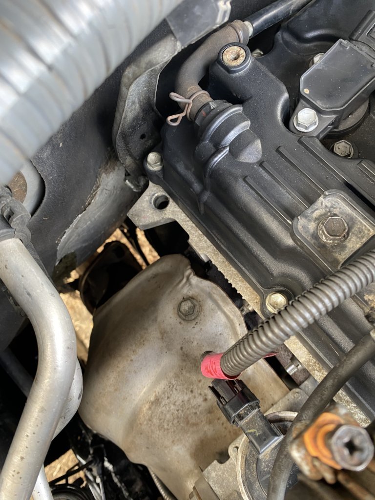

  8. Feb 9, 2025 at 6:25 AM
    #28
    jem122594
    jem122594 Active Member
    Jan 28, 2025
    #464966
    43
    Joseph
    2007 Tacoma 2.7 auto 2wd
    I was worried about this yesterday just over thinking. Have a 2007 Tacoma with a 2tr 4cyl
    Just installed low mile engine in it everything is running great temp garage shows normal but the top of the head is hot to touch if I touch the exposed surfaces that protrude out further then the valve cover itself. But it’s going to be hot read on google should be able to hold hand on it but I don’t think that is true
  9. Feb 9, 2025 at 7:07 AM
    #29
    Glamisman
    Glamisman Well-Known Member
    Oct 22, 2016
    #200436
    4,997
    There are 2 temperature sensors on Tacomas. One of them has a single wire and is for the dash gauge, the second is a 2 wire unit and that is for the engine computer. All scan tools read what the engine computer sees, not what the dash is showing.
  10. Feb 9, 2025 at 7:24 AM
    #30
    jem122594
    Jan 28, 2025
    #464966
    43
    Joseph
    Yeah I’ll get a scan gauge and be sure to feel more comfortable I think all is ok just over worrying. Rest of engine isn’t as hot. Just exposed parts of cylinder on pass side
  11. Feb 9, 2025 at 7:27 AM
    #31
    Dm93
    Dm93 Test Don't Guess
    Mar 3, 2015
    #150066
    13,813
    Texas
    2014 DC OR 6spd 4x4
    Predator tube steps, Ranch Hand grill guard, Magnaflow CatBack exhaust, Toyota tool box & bed mat, 2LO Module by @Up2NoGood, Rearview Compass/Temp Mirror, Tune by @JustDSM.
    Only 1st gens have 2 sensors, 2nd gens only have one.
