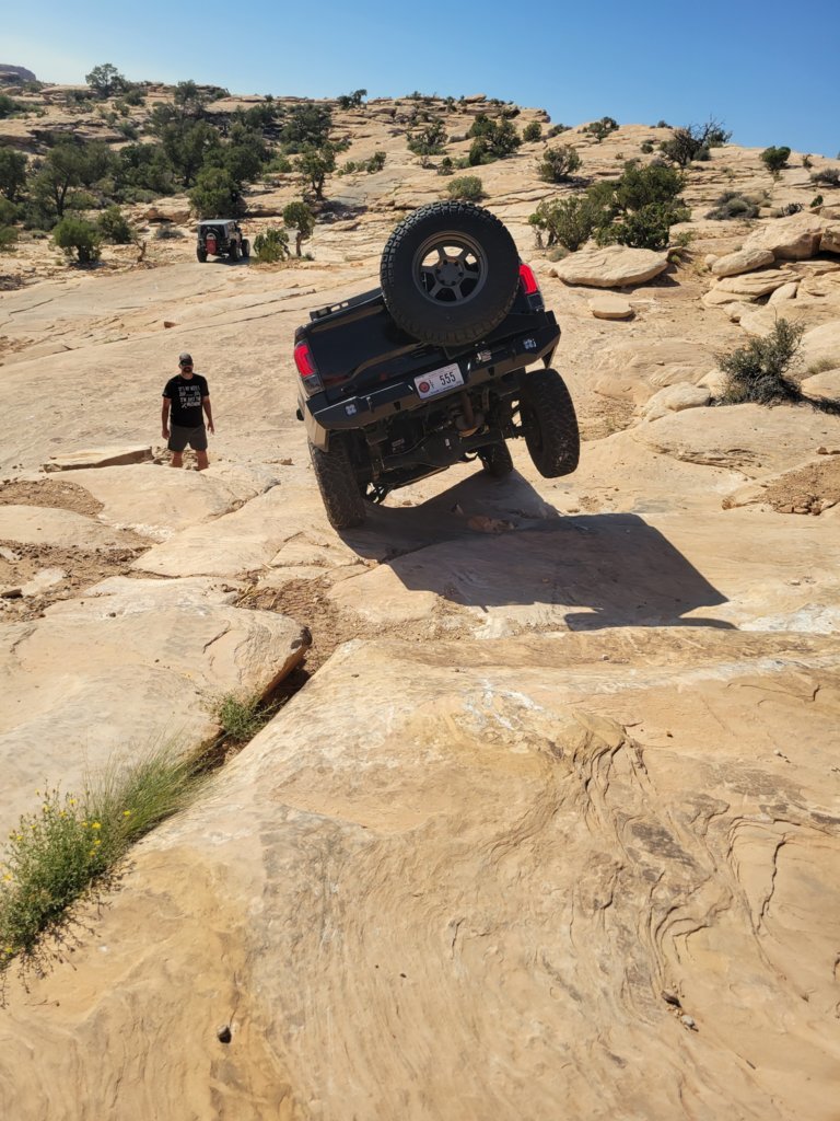

    Never had a problem at steep angles with my old 1968 M38A1 Jeep . With overall low range at 123.1:1 and Detroit locker in both axles it was unstoppable . Even back in the early 90's I had fun climbing the seven waterfalls in Surprise canyon that led up to Panamint city , That trail was closed in 2001
    This is my Jeep climbing up a steep incline in the East County of San Diego. The inclinometer on my dash was reading near 40 deg

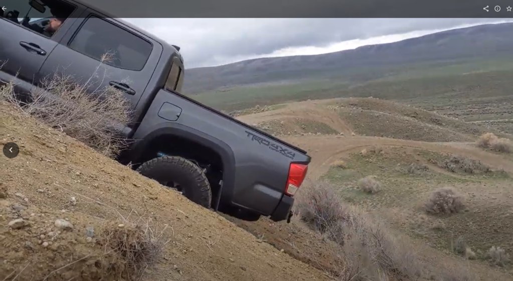

    I know this is old but my 2020 experienced this for a 2nd time this weekend. Same climb as a year ago, probably 35°. Half way up the engine threw the transmission fluid message and shut off. Sucked so bad. I had to go backward and pump the brake all the way. Started back up fine once level. Tried it again this past weekend and happened exactly the same way. I’m going to Utah next year and don’t want to be in a situation where this comes into play. Looking to see if it’s just my truck or all these trucks in general since the pitch and roll o ly go to 30° on the display.

    That PVC reroute kit will work or a catch can/oil separator will do the trick too. I have the J&L oil separator and have never had issues on inclines. I wheel my truck hard and have pointed my truck up some stupid steep inclines and never once has my truck let me down! If you have the money I would say get a dual catch can by Radium. It’s the best of both worlds. Here’s a thread talking about it.
