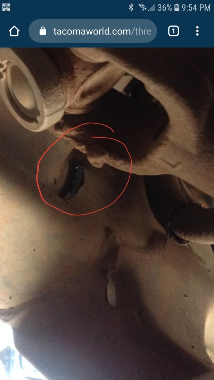

    [​IMG]I've looked on utube and see good videos on how to diagnose and replace. I'm just worried, dealer selling me something I don't need, to direct attention away from, vibration, lower RPMs, and engine bogging in 2nd gear, since engine work done to replace vvti gear.
