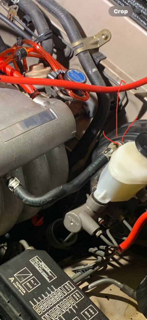

    I have a 2003 Toyota Tacoma PreRunner 2.7L 4cyl auto. This just recently started happening, but at totally random times (can’t create it consistently) when I apply my brakes, my engine totally stalls. I can leave it running for minutes and minutes, then I take it out and drive it, step on the brakes and it’ll just randomly shut off (power is still on thanks to the battery.) I replaced my MAF, cleaned the throttle body, replaced the IAC, replaced the EGR vacuum solenoid (the throttle body and IAC were throwing codes, hence why I cleaned the throttle body and replaced the IAC. Those lights shut off but it’ll still stall randomly ONLY when brakes are applied. I got a smoke machine and ran it through the different tubes, didn’t see any smoke escaping. I’m so bewildered. Going to replace the brake booster tomorrow as some said that may be the issue.

    I'm wondering if your brake booster is going bad, causing a huge vacuum leak when applying the brakes.

    You should test the brake booster either with a vacuum pump or a test procedure you can find online. They do wear out after a while.

    Another easy thing to check is the check valve on the booster
    One way valve
    If failing could cause symptoms your experiencing

    I have seen this check valve be incorporated in that vacuum hose to the intake manifold
    Unsure on a 2003

    I just replaced the whole brake booster tonight, drove it around a few blocks, nothing yet. Fingers crossed it stays this way
