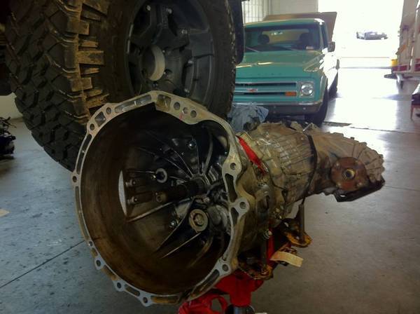

    ...........Or pulling the tranny out too. It's a bitch to get them seperated. When I did the clutch on my 98, I had to pry the tranny from the motor.

    Oh, and you did pull the starter out?

    The locating pins like to hold on for dear life. PB Blaster and a prybar. Tapping on the case with a deadblow hammer will help it separate. Don't wail, and don't use a regular hammer.
    The input shaft might be seized on the pilot bearing. It's going to take some wiggling to work it free.
    Patience and persistance are the keys.

    They'll definitely separate... it's the going back together thing that might be difficult using my method :eek:

    this, & a good pry bar , seperating it in a couple diff spots....

    Pull it together!!! I have done many engine swaps and this is the best way to do it.
