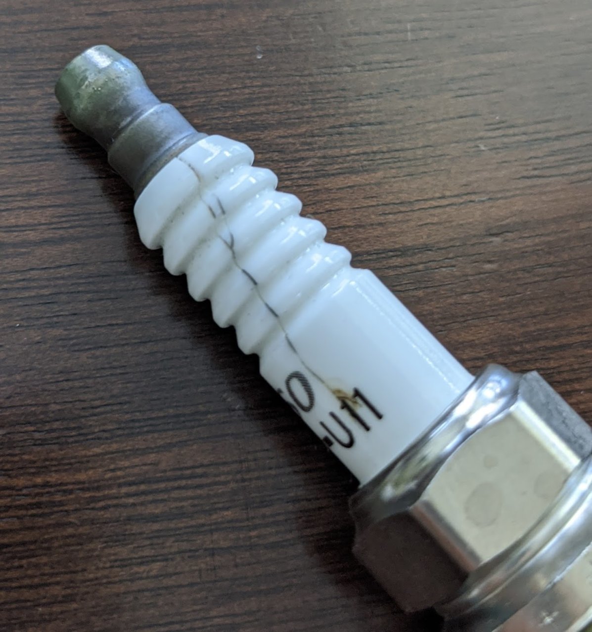

    BINGO!!! So I ordered a new set of spark plugs and guess what I found when taking out the previous set. One of the plug's ceramic was cracked on both sides.

    That is one nasty crack.
