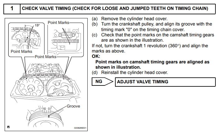

    I think pull the valve cover and check the timing.
