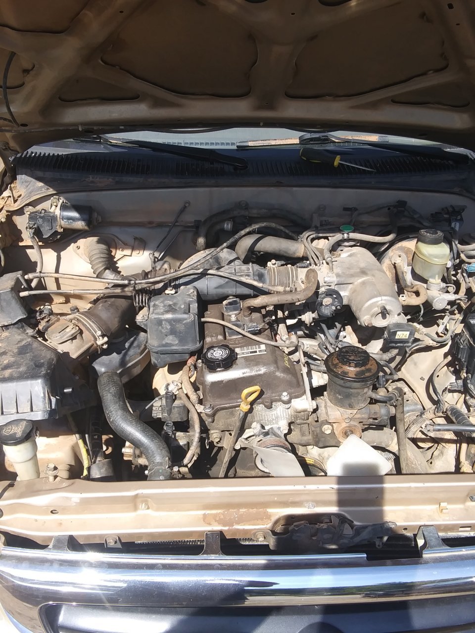

    Thanks for suggestions. I'll try to post a pic of my engine. I replaced entire engine. I didn't know toyota had 2 different 2.7 engines. One is a federal code and one is a California code. I swapped my valve cover over to the one my truck had when I pulled the engine. Now it will crank and is getting fuel but no fire.

    Well there's your issue. I'm seeing coil on plugs which was for 2001-2004 trucks. You need the coilpack style.

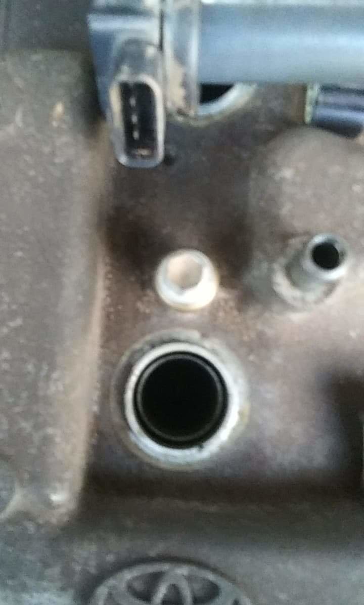

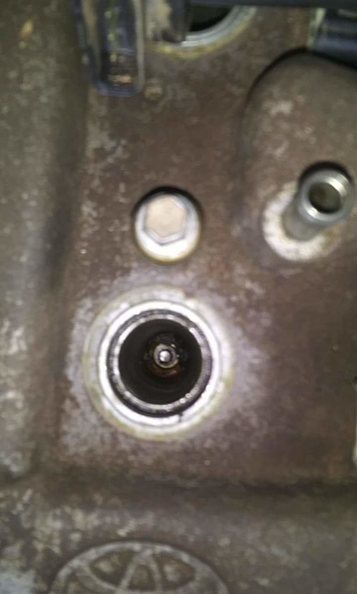

    I've got oil in back 3 plug holes. But when I got the engine it tipped over hauling it back. And it had gotten knocked over without my knowledge for Idk how long cause it took a month with the way I work and with kids to get it swapped in. Any ideas on what caused oil if it's not where it got tipped over? And how do i clean it out?

    Wet vac and 3/8 tubing, Copper tubing works best cause you can put a bend in it and rotate it all around,
