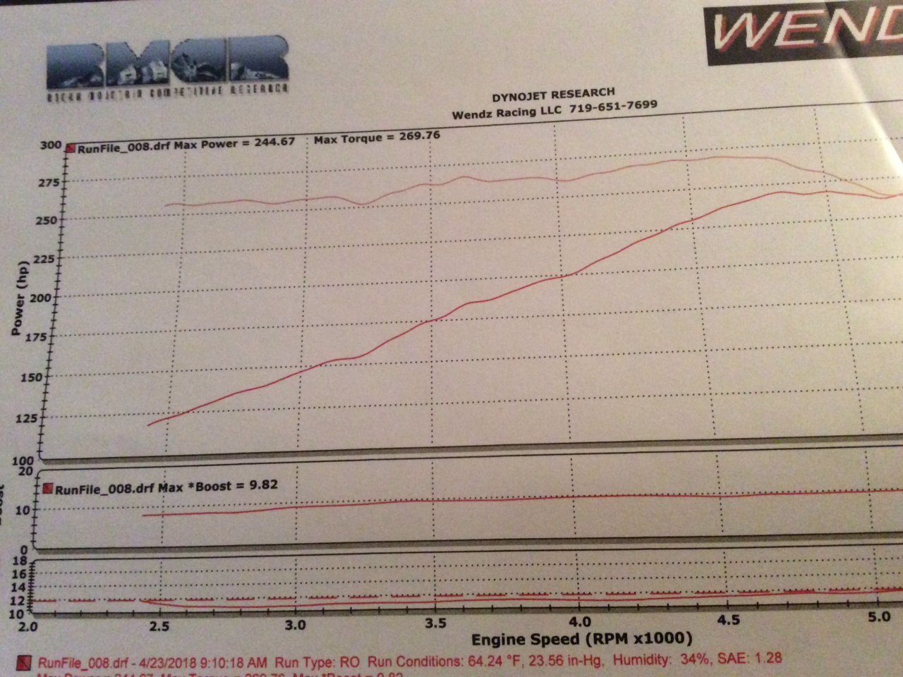

    These numbers are crank numbers not rear wheel horse power or toque numbers?
    Wouldn’t it just be easier to put in a 3.4 with a supercharger.?

    Power wise, the 4BT has 265 lb/ft of torque at 1600 RPM while the 5VZ only has 220 lb/ft of torque at 3600 RPM. Big difference.

    Ok I definitely understand the mpg,
    “Big difference” not at all, quite the opposite. The supercharged motor with a few mods puts out probably 300 hp and 315lb/ft torque compared to the 4BT at 265 lb/ft and the supercharger
    moves the torque power down to the lower 2000rpms. But I get what your saying.
    My REAR WHEEL torque is 270lb/ft while the 4BT is only 265 lb/ft at crank and if you figure
    15 percent loss maybe more? (as these are older transmission design) in the transmission and gears this number goes down to REAR WHEEL at 230 lb/ft give or take for the diesel and the REAR WHEEL supercharged 3.4 is at 270 lb/ft

    Rear wheel torque at 2000 rpms is 260 that goes up a bit more to 270 and that’s a daily driver
    AND NO the 3.4 supercharged will not go to 400
