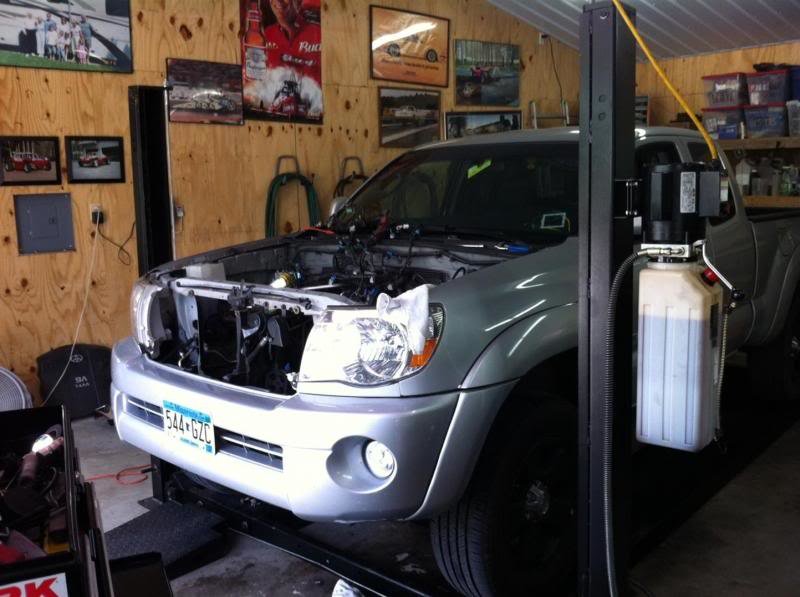

    We removed the engine today and all went good. We spent the first 90 minutes unplugging wires and labeling both ends as well as the new engine, all plugs thus far appear to be identical between my 05 engine and the new 11 engine. I was surprised that the 2011 engine (automatic) uses the same flexplate/flywheel bolts (grade 11) as my 2005. I was also surprised that there is no pilot bearing. Plan to degrease/pressure wash engine bay/trans and get flywheel resurfaced tomorrow then I will pick away at the reinstall this week.

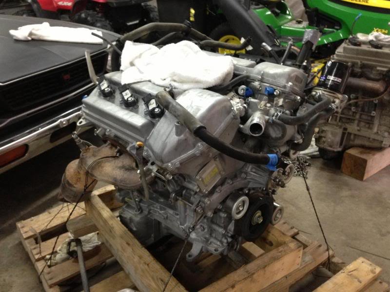

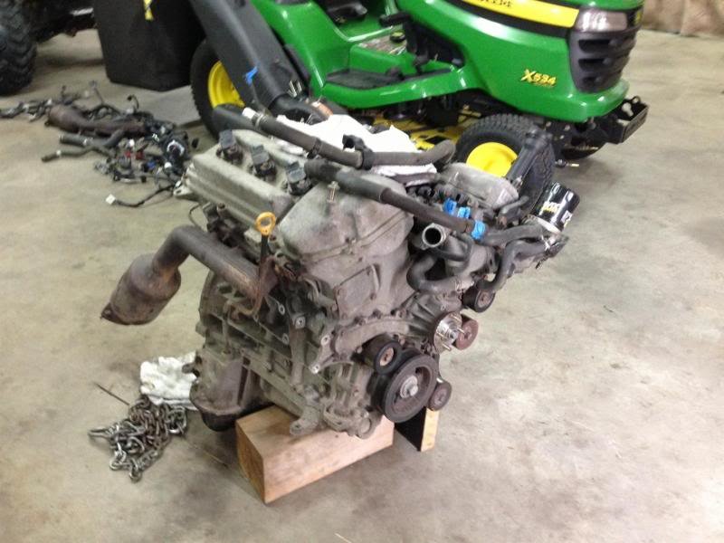

    PK: No damage, going to sell original engine so need to keep it nice. Yes the 2011 exhaust manifolds look much better (pics below) and also appear to "bolt in". I plan to take some pictures and post with some possible helpful tips when done. Thanks
    Bldegle2: there was no confusion on the engine swap, I gave them both VIN numbers and that is how they learned the new engine was from an automatic equipped truck. They said the engine was programmed to run with an automatic trans so it probably would not work. Time will tell...
    Thanks for all the comments.
    Damon
