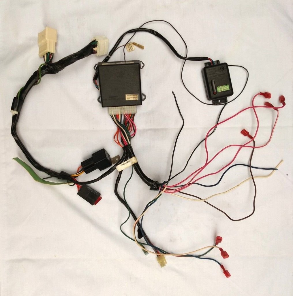

    Here's a picture of the demon from my 1999 model. This is the "Gulf States Toyota Alarm" system. It's not a kill switch but a full alarm and immobilizer. This may be different for your truck.
    To reset the system, I disconnected the battery, then removed the red 10a fuse, then reconnected the battery, turn the key on, then reconnect the fuse. I managed to clear the system. There is a routine that you go through by removing and reinstalling the fuse to reset the system.
