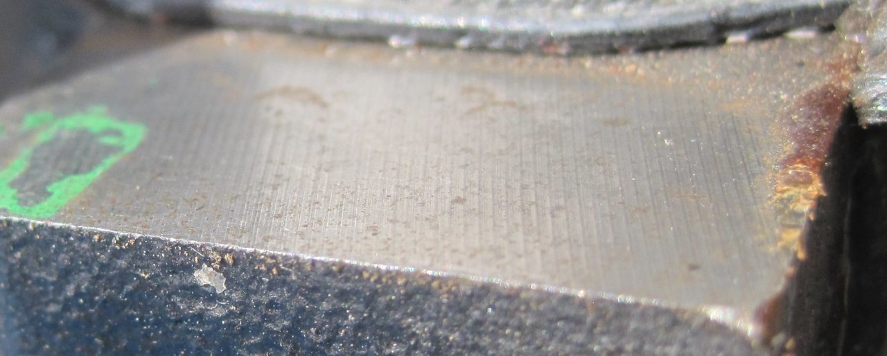

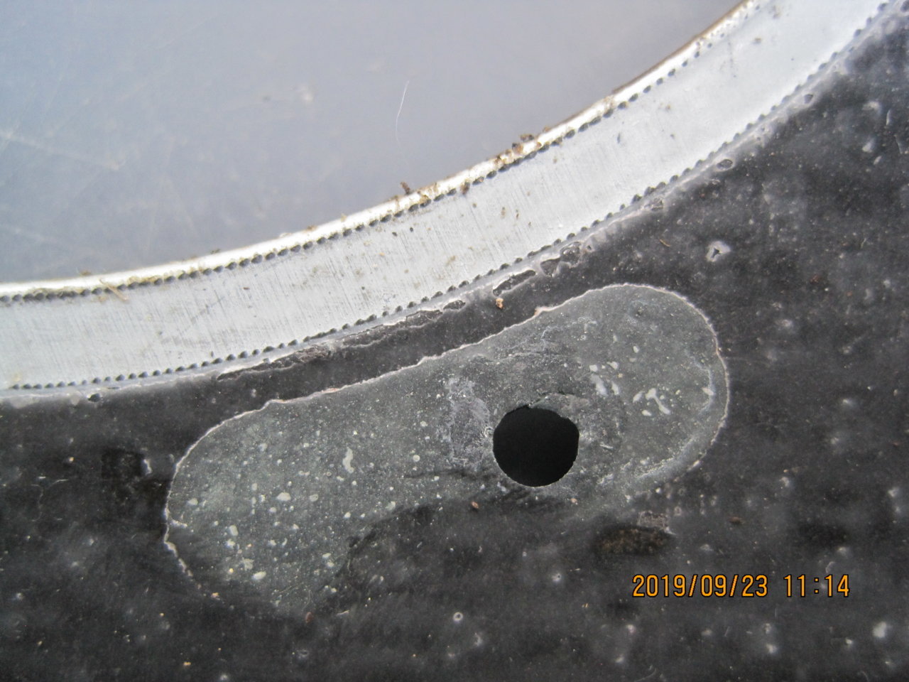

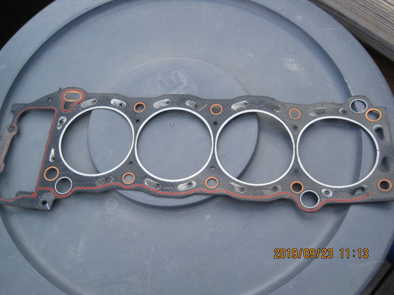

    Both engines they sent overheated under normal load. I also found exhaust in the coolant which confirmed their heads were leaking. On the 2nd engine I removed the head and discovered evidence of widespread leaking. There were white boiling stains at the water holes.
    First a precision straight edge and feeler gauge confirmed the block and head were flat.
    But on the block side of the head gasket there were dotted lines in the metal head gasket rings around the 4 cylinders. These matched the unsmooth machining ridges in the block.
    Since I don't have a $1000 surface roughness instrument, someone recommended I run my thumbnail over the surface and it should be smooth. But when I run my thumbnail over these blocks I can feel it, as it goes zzzzipp, as I go across the the ridges and valleys left behind from the cutting tool.
    Tip: I have discovered I can inspect the surface roughness without removing the head, by looking for a part of the block or head that protrudes from the other, and then inspecting that exposed surface area.

    Anyway even after some smoothing from a random orbital sander and super fine paper used for polishing solid surface counter tops, and with a new top quality head gasket and bolts this 2nd engine still overheated, just a little slower than before.
