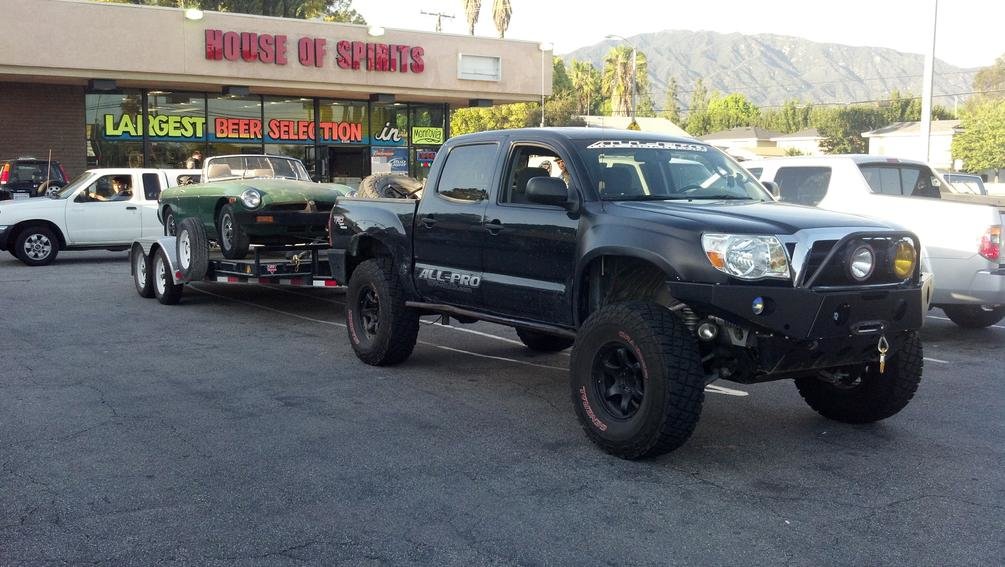

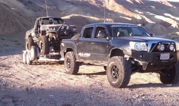

    My temp always stays the same when I tow the MonkeyCrawler..ofton I have to go up the Cajon Pass which is steep and filled with idiots who are barely doing 50 mph slowing my momentum down. Having. 4.56 gears help but I the tires that weigh 88lbs each takes away that benefit. I should look into getting a scan gauge just to see what The temps actually are..
