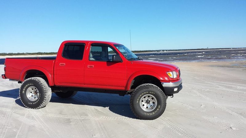

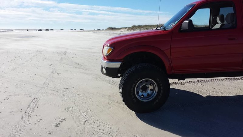

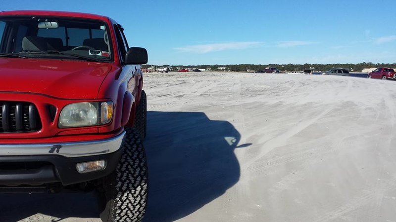

    Started out in 2wd high with shifter in L (1st gear), then went to 4wd high, last was 4Lo (with shifter in D). I do have 410 axle gears with 35x12 tires. When temp shot up I stop and idled the engine and the temp would come back down. Fan was working, and temp air was around 60 degrees. Drove 80 MPH for 3 hours to the beach and back no problems. I realize 80MPH is forcing plenty of air through the radiator.
