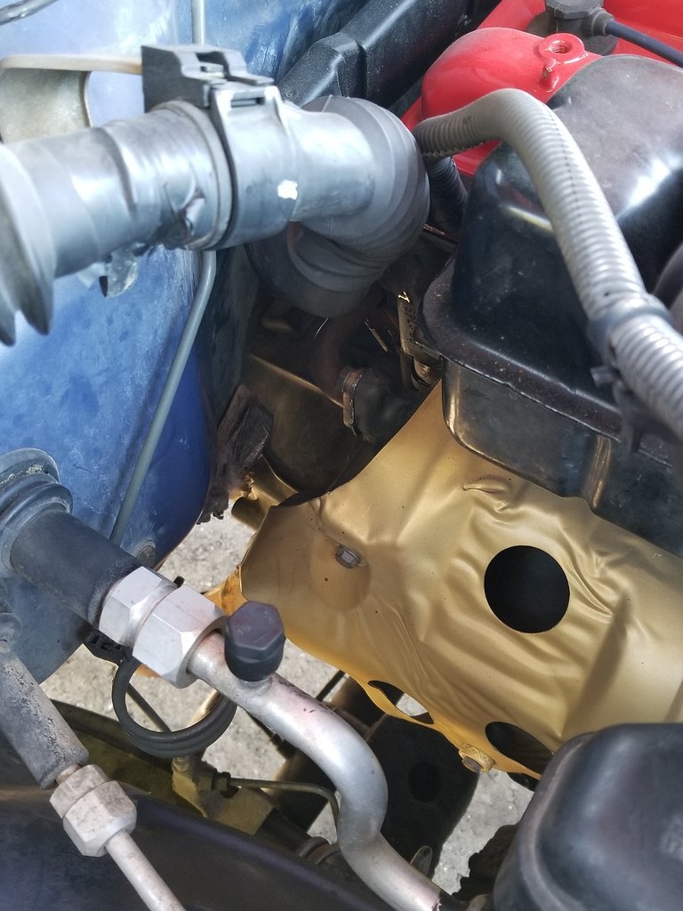

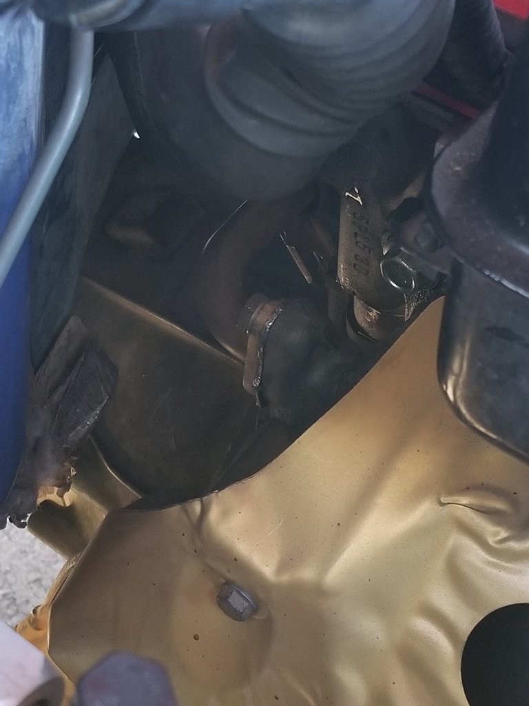

    On another note, I was able to eliminate the sound by installing a gasket and putting on new lock ring washers on the EGR tube mounting flange on the exhaust manifold. I got the gasket from Autozone for $3. Waaaay cheaper than from Toyota.
    I will take a picture of the tube and where it mounts to so everyone can see what I am talking about.

    This is on the passenger side of the engine bay. You can see the tube and where it mounts to on the backside of the exhaust manifold. The gasket I got is some type of graphite looking composite. The typical material that is used on exhaust components on all engines. I just dont know what that stuff is called.
