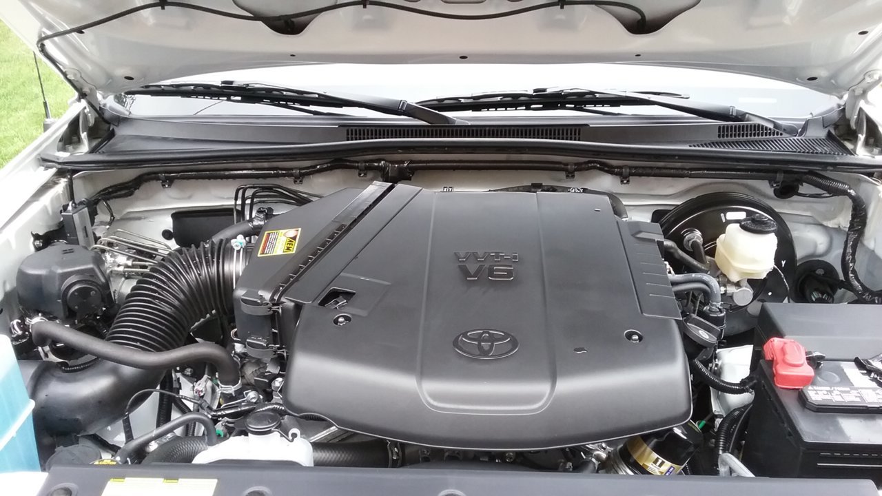

    A clean engine bay means it will be easier to spot problems. For example a leaking valve cover or a leaking water pump etc.
    Use a 50/50 premix of water/degreaser of your choice. Any of the above methods should be fine. Most electronics use weatherproof connectors but it does not mean they are pressure washer proof.

    192
    Florida
    2017 OR TRD 4x4
