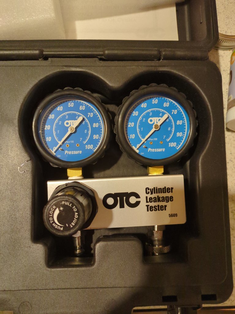

    Okay guys. Here's how it went.
    1.) Put the piston on cyl 4 to top dead center on compression side.
    2.) set the gauge to 90psi and pressurized cyl 4.
    3.) pressure went smoothly to 90psi and held.
    4.) removed oil cap and pressurized again. tiny bit of air coming from oil cap which I believe is normal. Pressure held at 90.
    5.) removed cyl 6 spark plug (air fuel imbalance cylinder)
    6.) pressurized cyl 4 again when it reaches about 60psi you can hear a blow out the gauge will go down to about 20psi then charge back up and hold at 90. This will consistently happen Everytime you do a fresh pressurize of the cylinder.
    7) put the spark plug back into cylinder 6 and pressurized cyl 4 with no blow out of air. Held 90.
    8) removed radiator cap, no bubbles.
    https://imgur.com/a/GlQNvXq

    So 4th cylinder only loses pressure when cylinder 6 plug is out? Does not make sense.
    The firing order is 1-2-3-4-5-6. I would think the intake valves are still opened on 6th.
    Have you tried pressuring 6th?
    helix66 likes this.

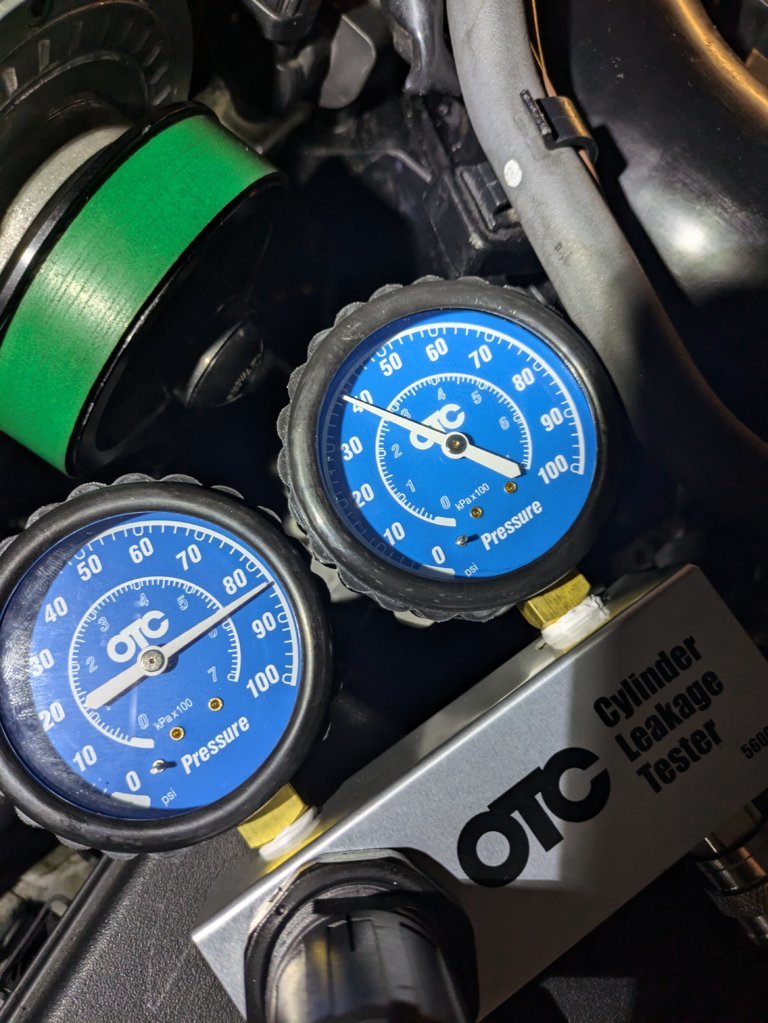

    Pressurized cylinder 4 again this morning with 6 plug in and it discharged about 20psi of air before reaching 90psi. Then I re pressurized multiple times and never lost air. I removed cyl 6 plug and pressurized cyl 4 again multiple times and I was not having escaped air like last night. Nothing has changed.

    Okay I'll check that now. Looks like the cylinder was moving on me and maybe that's why the air was being surged because the cylinder was opening up and needed more pressure. This cylinder might be fine
  12. Sep 28, 2024 at 5:08 AM
    #212
    sherwoods_Fleet
    sherwoods_Fleet [OP] Well-Known Member
    Jun 29, 2019
    #297783
    246
    2019 Cement manual Tacoma+
    Procharger 5.29 Nitro Gears 6 inch RC lift 35x12.50r17 17x9 -38 offset, 3.5 backspacing SCS Ray10s Gunmetal gray. OEM Audioplus sound system Accumulator Delete
    The piston is at the bottom now and I'm assuming that the quick burst of pressure was pushing the cylinder down a tad bit which maybe made it sound like a burst of air? With cylinder 6 plug out it might have been easier for the engine to rotate and what sounded like air flowing into cyl 6 might have just been the cyl 4 piston pushing down slightly at a time which then drops the pressure until it charges back up to 90. Now that the piston is at the bottom there's no loss of pressure at all in cyl 4. I assume the exhaust valve hasn't opened yet with it at the bottom of the stroke.

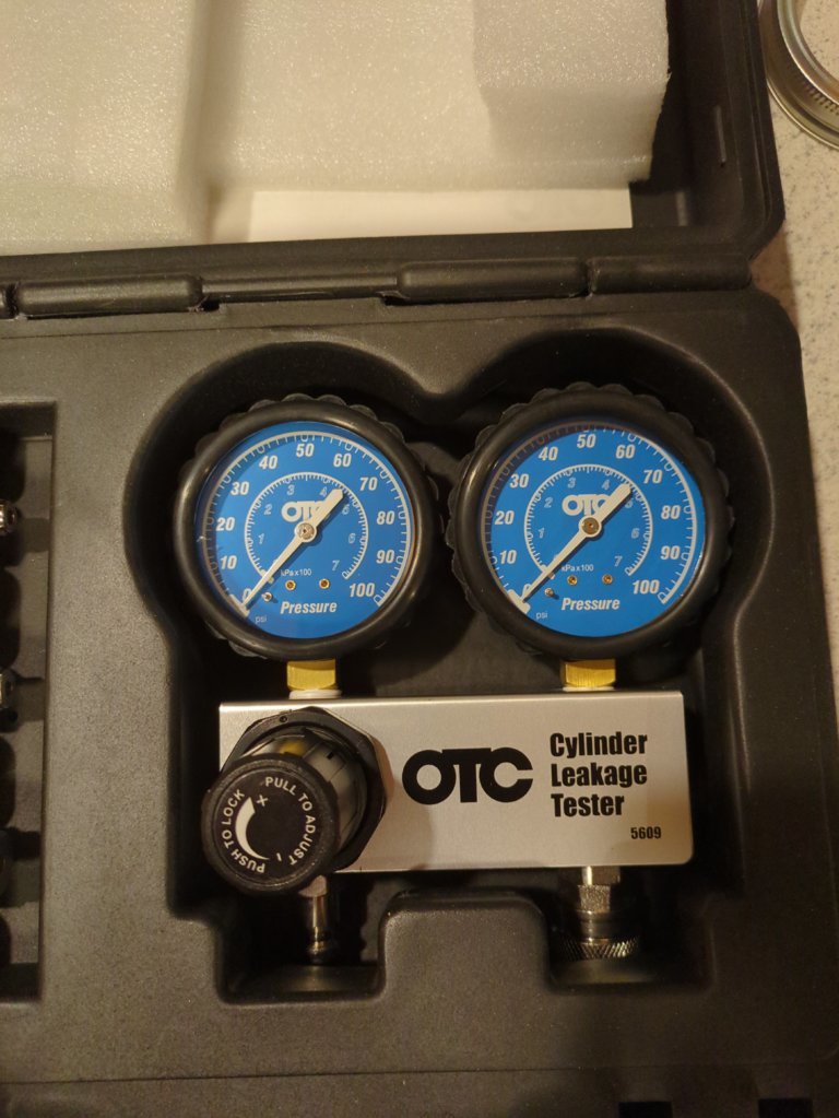

    Intake has a lot of air coming out from the cyl 6 leak down test. PXL_20240928_134359901.jpg

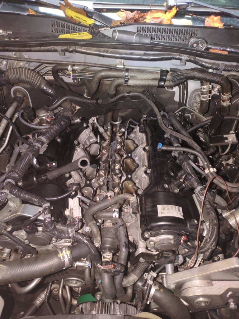

    Alright guys. Started tearing down the engine a bit. Removed the lower intake to verify both valves were closed when doing leak down test on cyl 6. After making sure they were I put pressure into the cylinder plugged the 2 valve case hoses and when opening the oil cap the oil cap flew off.
    My only chance is removing the head and seeing if it's cracked and only replacing the heads. If no crack must be piston rings.
    Once this is back together I'll never mess with rpm again. I'd say the tune allowing me to go to 7k rpm along with me having 5.28 gears in a manual which climbs the rpm wicked fast just caused me to screw this engine up. I was honestly chasing boost with rpm and I should have been conservative with it. Kept a 5.5k rev limiter to be safe and maybe changed the supercharger pulley to get more boost. Lesson learned. I'll keep everyone posted on the process. I'm not paying no stealership to do this work so I'll be wrenching when I can after work or weekends.
