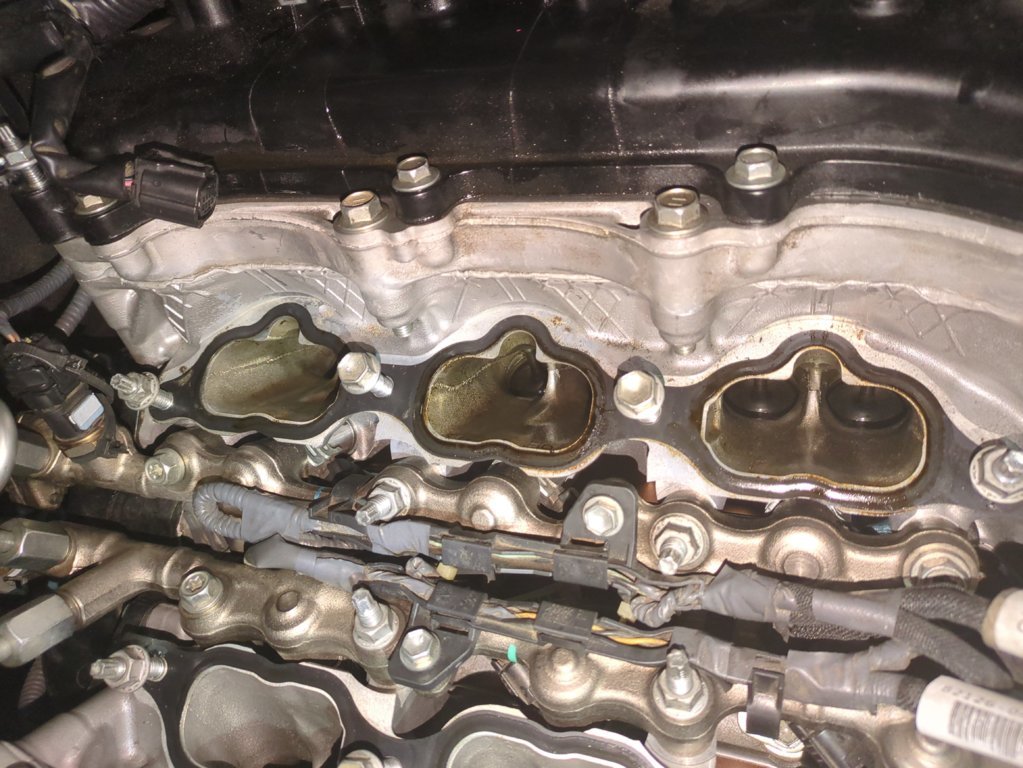

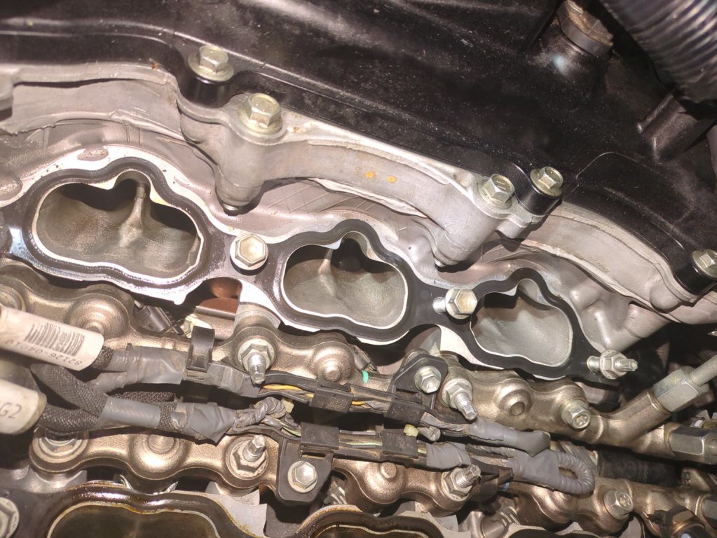

    I will say something to note is the whole bank 2 is covered in oil. 17276299089433231806175775879840.jpg 17276299318405400089231057263654.jpg

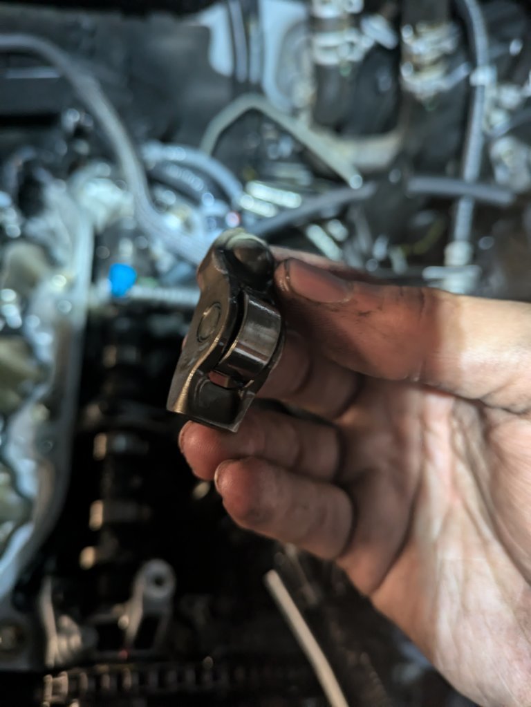

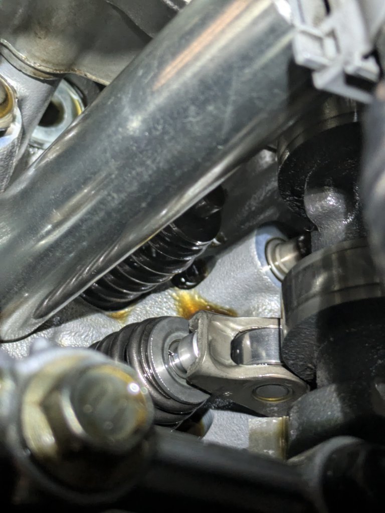

    Well found the misfire on cylinder 4. PXL_20240929_183505273.jpg PXL_20240929_183440334.jpg

    If only one bank is covered in oil, then perhaps it’s a ring(s) or valvetrain issue on that side. Perhaps there is oil in the catalyst system as well?
    Wouldn’t the combustion process go lean if oil is present?

    I sent photos to the shop..this was clearly done during reassembly of the heads. This only relates to the misfire on cyl 4. I still have a loss of 50% in cyl 6 probably through piston rings. I could loosen the cam and slip the rocker back on to get rid of the misfire and limp mode. Then put thicker oil into the engine and see if it will get me by for a while? What would you guys do?

    Does anyone know if I can just loosen the cam caps to squeeze the rocker back into place then torque them back down without issue?
    Update:
    I loosened all the bearing caps and was able to flex the cam up just enough. It didn't take much and in the process I had 3 more rockers pop off when I lightly touched them. Finally was able to get all 4 rockers back in place lol.

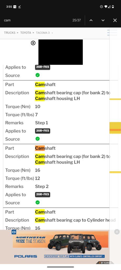

    Now gotta torque it all back down. They seemed over tight for sure. I'm going off of this spec. Screenshot_20240929-155525.png

    I'm learning a lot from this. One thing I've just found is that these engines can spit rockers out if you exceed 6400 rpm. I also learned some on the whole valvetrain setup. Interesting setup they use for the hydraulic lash on the lifter. Glad to see it didn't tear anything up.
    I find it interesting how only one bank has oil in the intake. Not sure how that could be.

    Yes...that's very strange. I don't understand why. Even if oil is spilling from cyl 6 rings ALL intakes should look bad. I will say that whole bank was misfiring because of cyl 4 rocker issue. So maybe it's less oil and more of a burnt look. There is oil yes but the discoloration might just be misfire heat? Not sure.
