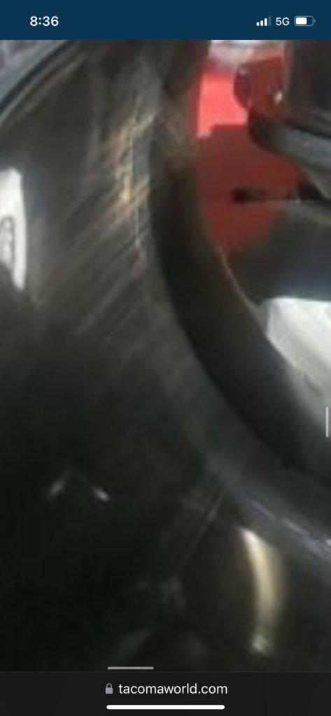

    Ill give you that, there is crosshatch now that you provided close up...
    BUT the vertical scoring is even worse than I initially saw & suspected.
    But end of the day, you still just want to wing-it & just slam it back together with zero machine work from an actual machine shop....
    See all those vertical lines throughout the entire circumference of the cylinder????
    None of them should be there...
    On a bad engine I see 1 or 2 on the inside which require an actual machine shop to do what they do to do it right...
    You have it everywhere.....
    You little SC "that everyone runs" destroyed your block, it needs proper machining....
    Look at all your other lower piston skirts for scoring...
    You have 1 dead piston but all your cylinders are beat!
    Yes, it doesnt need to be a race car....
    But youre on the path of making it an oil burning POS, but hey, it will be SC....:thumbsup:

    Vertical scoring lines should not be there at all, on a good cylinder.....
    Im not over-reacting, thats not slight / mild scoring that anyone that knows what theyre actually doing will just close their eyes to....

    Dangggggg!! That’s a goner lol!

    You could probably feel that with your nail. Ask me how I know….

    Its not just 1 hole, its all 6.....
    probably not but regardless if you can or cant, all the pistons are still toast & block needs real machine work......
    Will it run without it, yes, but, will be a joke, low on compression & consume oil, will not last very long before its toast again...
    Im not trying to be a dick, if I was, ide just bite my tongue, sit back & watch.....:facepalm:
