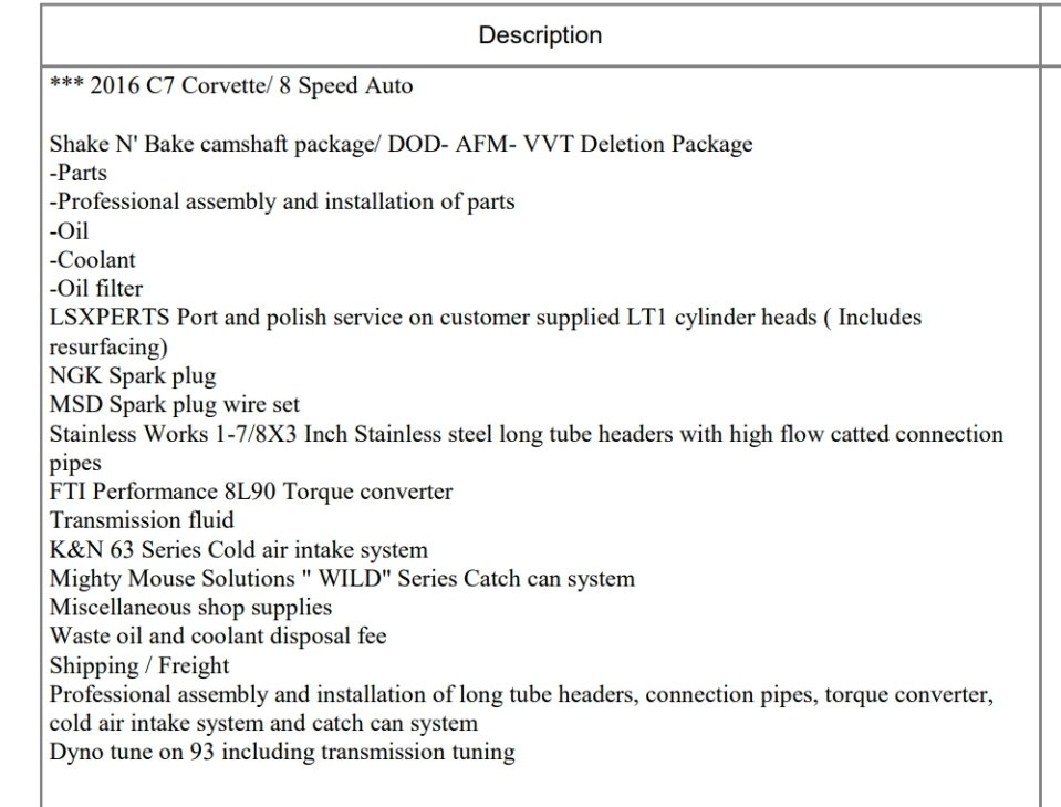

    Ooo, what's the corvette motor specs? :popcorn:
    418lsx? fast 102 intake? afr heads? lumpy cam? :burnrubber:
  4. Jun 16, 2025 at 4:58 PM
    #364
    sherwoods_Fleet
    sherwoods_Fleet [OP] Well-Known Member
    Jun 29, 2019
    #297783
    246
    2019 Cement manual Tacoma+
    Procharger 5.29 Nitro Gears 6 inch RC lift 35x12.50r17 17x9 -38 offset, 3.5 backspacing SCS Ray10s Gunmetal gray. OEM Audioplus sound system Accumulator Delete
    The mightiest of cams.
