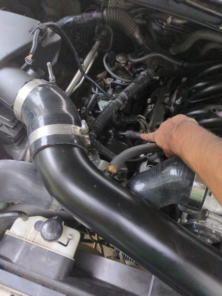

    That's interesting, now I want to take my intake off and check lol. Possible that it's broke and covering port 6. I assume when the valves were done they removed it and would have noticed the flap being broken but...I'd have to see it for myself. Grabbing some wrenches :cheers:

    I would just pop off the throttle body and use a camera to check if it's still in there correctly

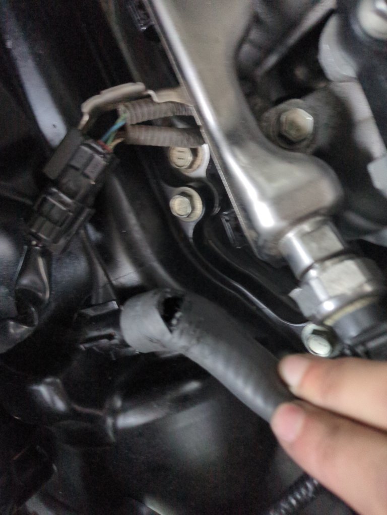

    Almost have the air intake off to check that flapper...found this lol. Probably not contributing to keeping air in the system?
    OldSchlPunk and auskip07 like this.

    probably not the issue but good catch

    Looks like my flapper is in tacked. I can't really see it but there's no rattling when I shake the intake manifold. Gear is still attached too.

    What is that to/from?

    Cam cover, PCV?

    Breather for the crankcase vent system

    Yup, and with the supercharger even though a small hole would definitely be sucking in air that's bypassing the MAF. But shouldn't be causing issues on cyl 6 specifically.
