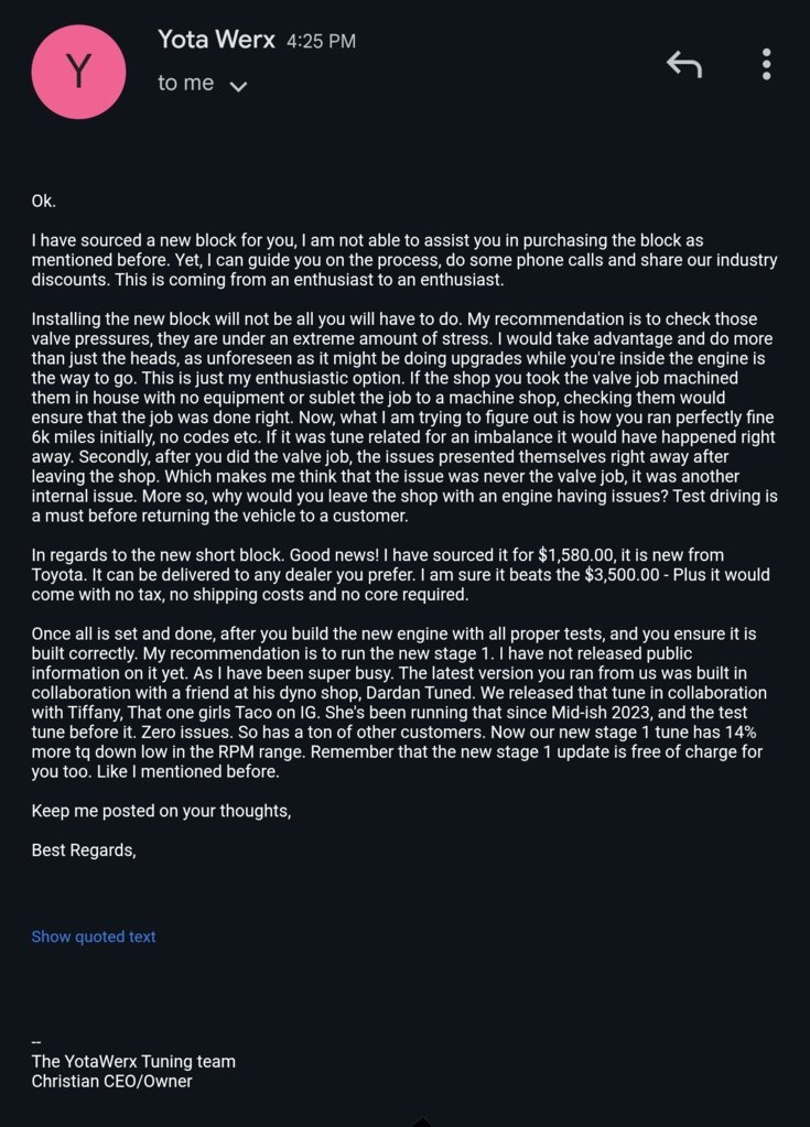

    So Yotawerx states they found a NEW block for 1580$ I'm not sure how...but if this pans out they would be doing me a solid. That's a massive saving compared to what I was about to spend.

    Still didnt answer the question, unless I missed it....
    How much lbs of boost are you running!!!!!!
    Lets be real here....
    You mention theres plenty of people running sc's on Tacomas....
    5lbs or 14lbs on a stock bottom?
    Some pistons are better suited, & what frank is doing to his rig, may not work of Freds....

    Nevermind, I saw it, 4-7lbs...

    Yeah pretty low psi. Stock internals have been handling these boost numbers for many others.
