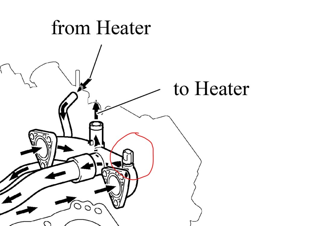

    The wires pulled out of the connector for the sensor connector that's in the heater bypass. Does anyone know what a part number would be for a pigtail connector that I can solder back into the wire harness? Not sure what this sensor does unless its a secondary thermostat sensor.

    Coolant temp sensor. Should be Toyota 90980-12416 or Sumitomo connector 6189-1161. Please verify that, I only looked quickly. Pins and seal will be offered along with it through various vendors, or you might find a pigtail version.
  14. Jun 18, 2025 at 11:02 AM
    #414
    sherwoods_Fleet
    sherwoods_Fleet [OP] Well-Known Member
    Jun 29, 2019
    #297783
    246
    2019 Cement manual Tacoma+
    Procharger 5.29 Nitro Gears 6 inch RC lift 35x12.50r17 17x9 -38 offset, 3.5 backspacing SCS Ray10s Gunmetal gray. OEM Audioplus sound system Accumulator Delete
    Thank you! ill order one and see if it works. I'm assuming polarity does not matter with this sensor?

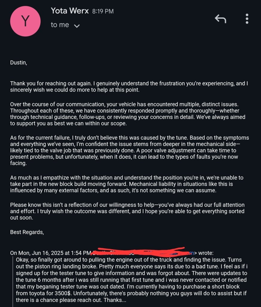

  16. Jun 27, 2025 at 4:15 AM
    #416
    sherwoods_Fleet
    Jun 29, 2019
    #297783
    246
    Yotawerx stopped emailing me after saying they can source me a block for 1590$, anyone have any hookups for a new shortblock? If not, I'll have to just get a new one for 3500.
  17. Jun 27, 2025 at 4:21 AM
    #417
    MGMDesertTaco
    MGMDesertTaco Come on, live a little...
    Jan 30, 2021
    #354573
    10,287
  18. Jun 27, 2025 at 6:26 AM
    #418
    Off Topic Guy
    Off Topic Guy 2023 Trophy Points - Runner Up
    Jan 13, 2022
    #387135
    2,634
    That sucks. Its very possible they didn't want their gesture to be public knowledge/to be seen on this forum. Sure, it could make them look good, but could also make them look bad too. The nice gesture could insinuate they're helping out of guilt. Or it could truly just be a nice gesture and now everyone with problems expects the same deal in return. Or maybe they're just having to jump through hoops to make it happen, and they won't have an update for you until they lock it in.
  19. Jun 27, 2025 at 7:32 AM
    #419
    sherwoods_Fleet
    Jun 29, 2019
    #297783
    246
    Yeah, it's the owner of yotawerx that's making things right by assisting me with a connection he has. Its known and seen in this forum that i was an early tester. Them seeing my motor become damaged from their tester file is what being a tester is about. You fix the problems and push out a final tune thats safe and damage free. The public should know that if they help me out with a block its because I was willing to HELP THEM first. But communication went dark and ill be sure to have any community im involved in to use OTT over Yotawerx, I have all the records, data and photos to show other communities. Just looking for the best price out there now so that I can get back on the road.
