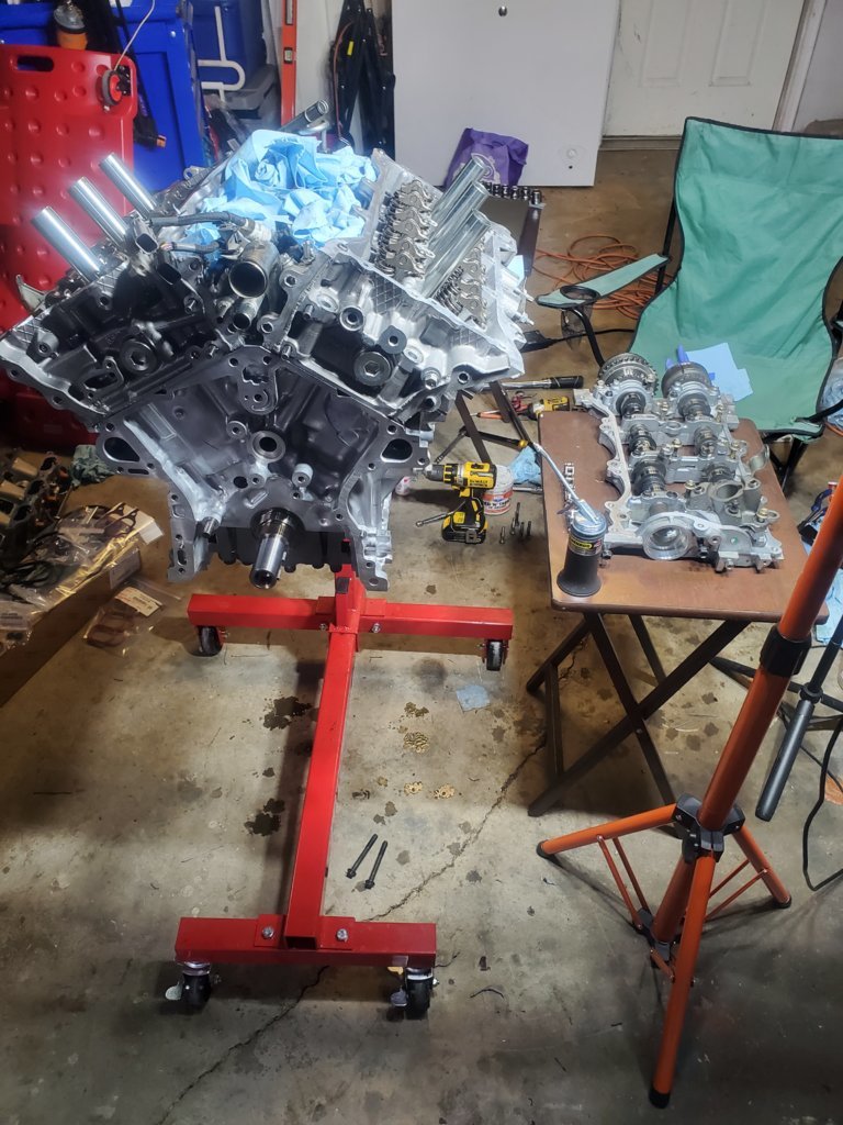

    Cam housings, timing and timing cover :cheers:
    Timing cover and hoping you did the timing correctly has my anxiety through the roof.
    Have about 10hrs to go through to make a fairly simple walk through. Going to make sure the truck runs before posting though heh.
    WilliamJames, nDub, BLtheP and 2 others like this.

    Spin by hand to verify marks.

    Correct me if I'm wrong but once you set all the marks you have to rotate the crank twice for them all to line back up? And the chain won't line back up for many rotations? The chain is what was throwing me off but after a few rotations the bank 1 and bank 2 cam sprockets and crank sprocket all lined up again.

    You need to rotate the crankshaft like 50 times to get chain marks line up

    Do you have to have cylinder 1 at top dead center or just line the sprockets up? The proceedures didn't mention having cylinder 1 at TDC, if so, I'll have to redo the time tomorrow.

    Cylinder 1 must be in tdc. Crankshaft mark should be in tdc

    Crank shaft mark was in the correct location but I didn't verify that cyl 1 was physically at top dead center...oof. I'll watch the pistons from the bottom and see if it's in TDC when the marks like up.

    You should be fine if crankshaft mark was in tdc

    Just double checked, spun the engine upside down and looked at the pistons from the crank area. When I put on the valve cover I had the marks lined up and I slowly turned the crank and cyl one piston started to come down so yeah, I should be in time...phew had me worried lol

    Next important item to install the relactor wheel correctly.
