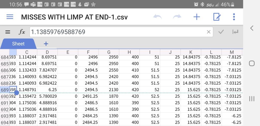

  6. Sep 13, 2024 at 7:38 AM
    #106
    Vlady
    Vlady Well-Known Member
    Dec 20, 2017
    #238986
    4,523
    Issy, WA
    2017 White SR5 DCSB V6 4x4
    Can you check if you are running in Closed Loop?
    The data suggests a lean condition at 20% of accelerator and 2500 rpms

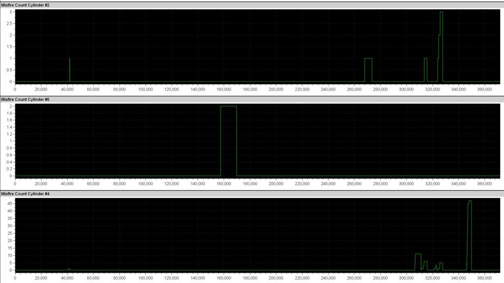

    seems like the whole side of the engine is struggling with misfires. cyl 2,4,6.misfire 2,4,6.jpg

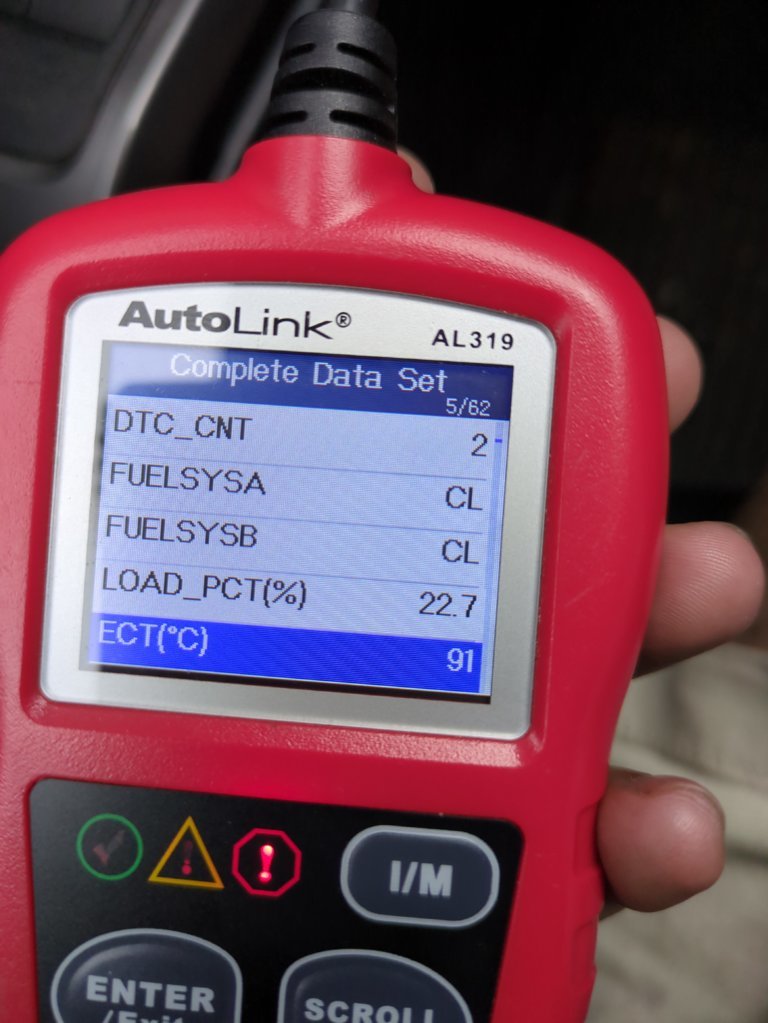

    sure thing, let me get the truck back up to temp and see if its in closed.

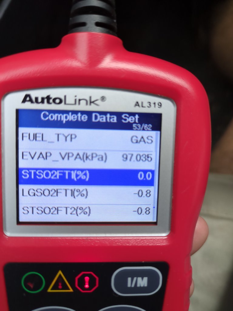

    My EVAP pressure seems high? Don't know if it matters but throwing it in here for troubleshooting purposes cause there's a lot more smarter people in here than me lol. 17262391797215916823639609616456.jpg

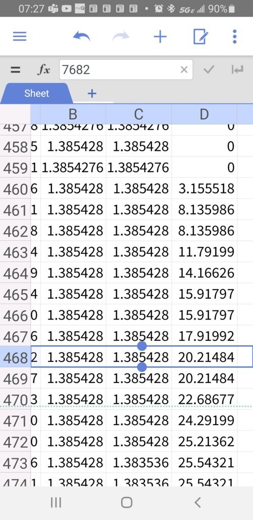

    Fix your vf logging for fuel trims. Add total fuel trim.
    Add maf, coolant, injection mode, engine load. Knock FeedBack, cat temp
    I would add vvt i change angles target and actual.
    Look at lambda at 0 accelerator (fuel cut). You have 1.38, ltft is at +7%. Normal lambda is 1.23 and usually ltft is in negative.
    Also see this segment
    Ltft is rising with no affect on lambda. Lambda is rising and is in lean condition.
    I would smoke the intake for leaks, etc.
