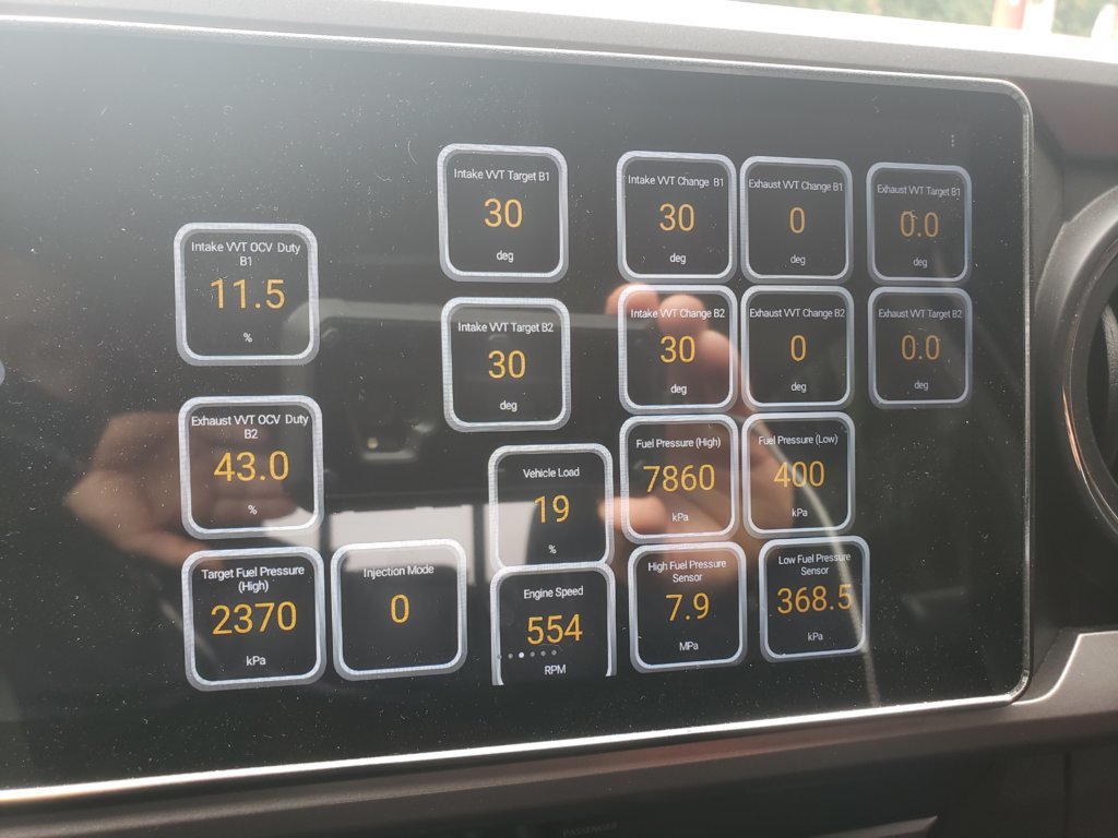

    as requested see attached.

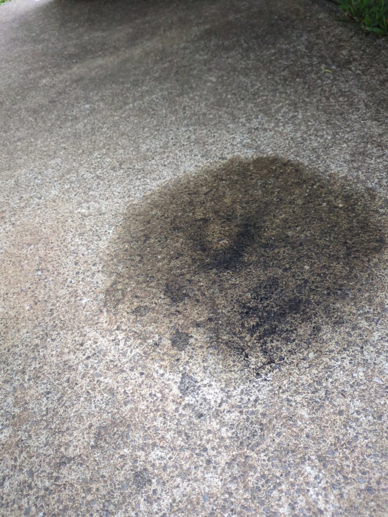

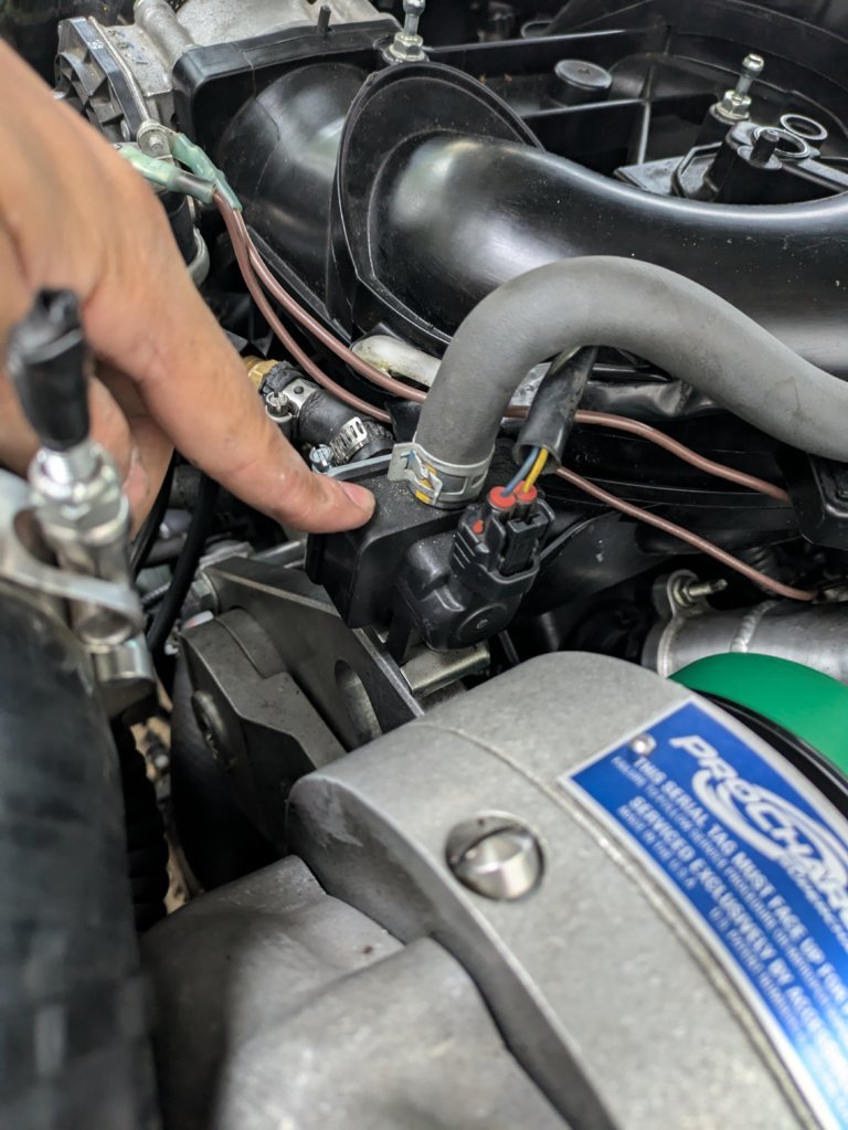

    Also my vapor canister is rapidly actuating I can hear it clicking rapidly even over the supercharger whine. Obviously if I unplug it it stops and then the motor seems to change in tone. Is it normal for these solenoids to constantly actuate?
    Also a lot of black stuff coming out of exhaust. There's a small puddle of it after the tests in the driveway this morning. Doesn't really smell like anything.

    Something with high pressure. Goes from 5 digits to 4.
    Add injection mode and retest to see if pressure drops when injection mode comes from 0 to 2 or 1

    It actually seems like it's working backwards. Should be 4000 kPa at idle.

    What units of measure in vf? In my techstream logs, I see 4 digit pressure for "fuel pressure high" in psi
    2 digit for low in psi
    Replace fuel pressure pids with sensor pids
    -Add high fuel pressure sensor. It should be in MPa.
    -Add low fuel pressure sensor.
  16. Sep 14, 2024 at 10:13 AM

    I'm confused with HP pressure in the log. Did you get a correct PID for it?
    Here is my HP and LP numbers at idle

    Yup should be the correct pids. I do have a fuel module that increases voltage on the do that came with the procharger. Probably the reason my numbers are higher.
    What's your HP at 3k rpms?

    With a load in Direct mode at 18000-19000 KPa

    Way higher than mine...

    Mine wasn't under load though I don't think. I was just in neutral revving it.
