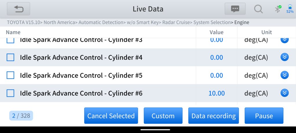

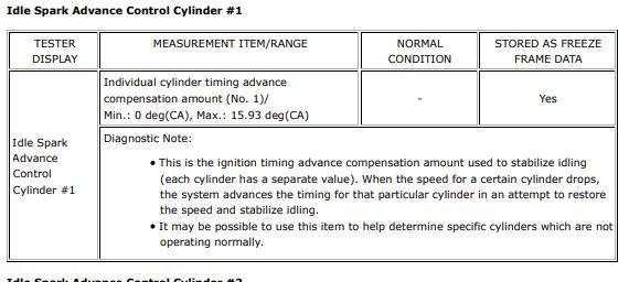

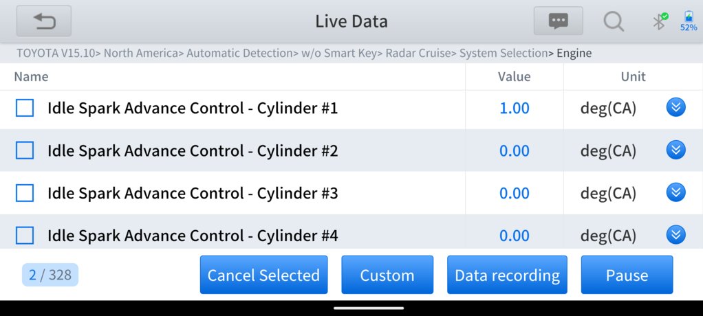

    Well truck got worse somehow. Long fuel trims are even higher than before up around 15 in idle. Checking for leaks again tomorrow but I don't think I have any. Anyone know if this cyl 6 advance is bad? Just seems odd to be so different from the rest. Screenshot_20240920-225236.png Screenshot_20240920-225230.png

    it is within normal range. Here some notes. You need to test compression and do a leak down tests on bank 2 cylinders (6th maybe leaking). You can drive with P11F1, but P0304 will put you in limp mode all the time
    Toyota fuel trims are normal between -15 to + 15%.
  5. Sep 21, 2024 at 7:32 AM

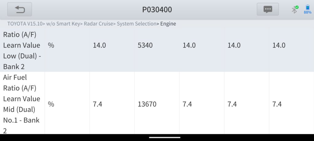

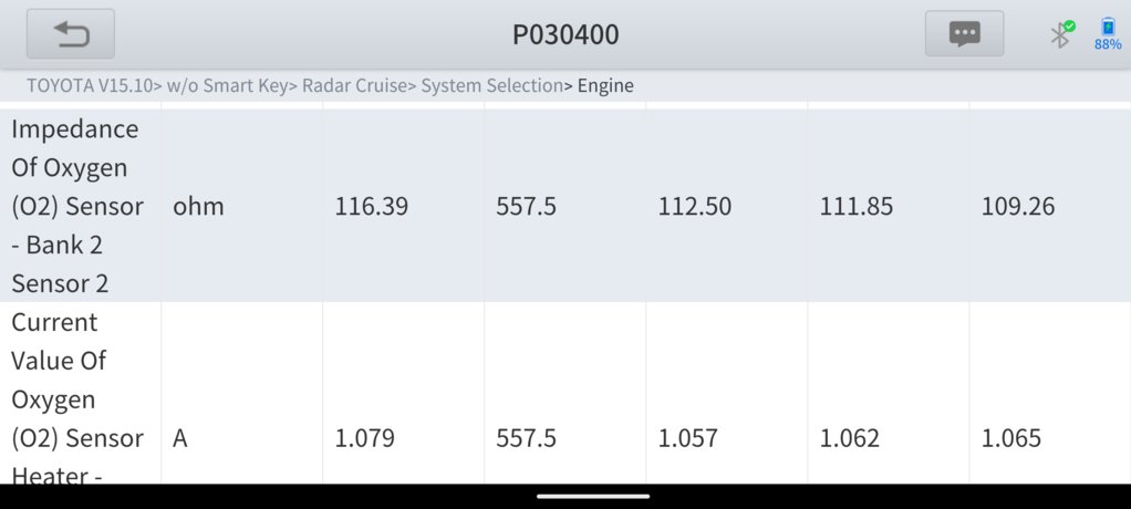

    Still lacking a lot of the necessary tools to do these tests. But I think I'll have to just purchase them soon. Forced the truck to misfire twice on this last drive so I could see freeze frames. I noticed that sensor 2 always spikes very high impedance when it misfires. Does this tend to happen when you have a clogged cat? I'm assuming the truck has been running lean for a long time so would that cause clogged in the cat which will cause this impedance spike? Truck is getting basically no miles to the gallon, very poor acceleration, weird ticking noises from engine occasionally and can't handle high load. Let's assume that bank 2 is clogged. Since cyl 6 keeps having air fuel mix issue is the back pressure keeping the exhaust valve open? Screenshot_20240921-102648.png Screenshot_20240921-102735.png Screenshot_20240921-102836.png

    Rich conditions cause clogged cats (carbon deposits that can't burn off). Clogged cats don't magically unclog. Back pressure can't overcome valve springs. No miles to the gallon would suggest terribly rich, not lean. Lean burning will lead to burnt valves and damaged pistons/rings.
    You said early on the shop determined you had damaged exhaust valve in #6, correct? They also said low compression on #6, right? IIRC, leakdown test pointed to leaky rings.
    Seems to be considerable inconsistency.
