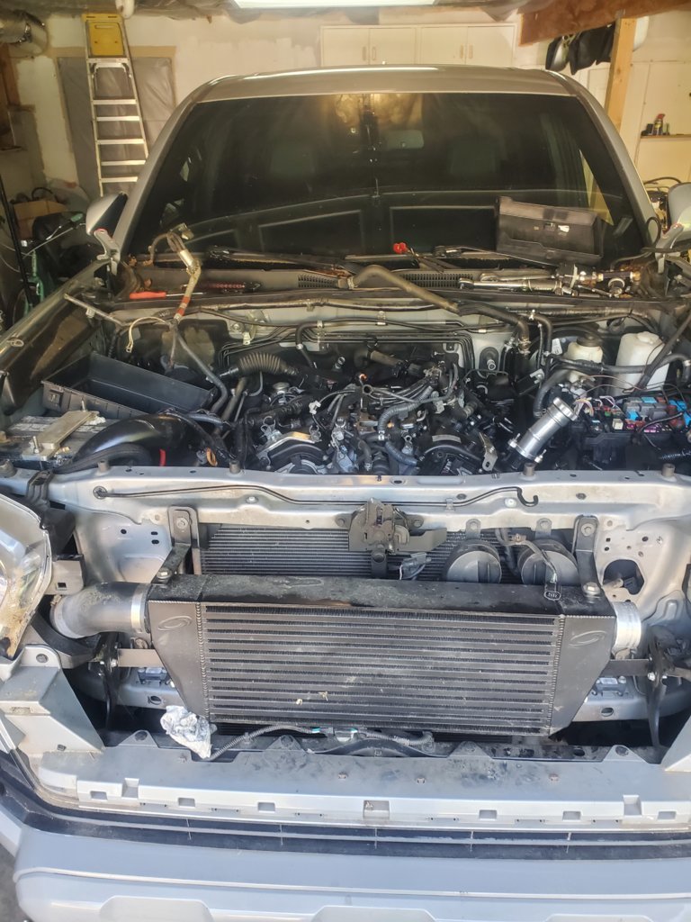

    Just an update, did a leak down test and cylinder 6 is leaking about 60psi out of 90psi into the oil pan. Definitely must be a shot piston ring.
    Finally pulled it into the garage today and stripped almost everything off the motor. Have to remove the exhaust manifolds, buy a million extensions to get the bell housing bolts removed and then will attempt to pull it.
    Next I'll be throwing it onto my engine stand and checking out cylinder 6, if it is a piston ring should I just replace the piston rings/get new pistons in and call it a day? Everything else seems fine. I fired it up and drove it into the garage with no issues. Seems like the issue starts when it reaches temp.

    Get a new to you engine if the piston is shot. These are essentially disposable engines. Short of doing sleeves and built motor, your best bet is to get a used long block.

    Looks like I can get a brand new Toyota short block for 3k. I'll probably go that route and swap my heads over.
