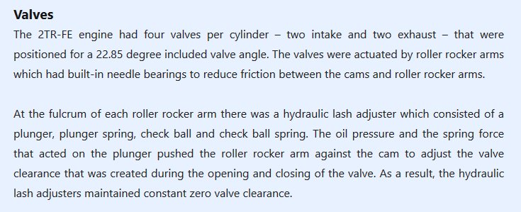

    That would be correct for the Older 2.7 and 2.4 engines ( 2RZ and 3RZ ). For the modern 2.7 liter engine 2005 and up 2.7 2TR-FE uses hydraulic adjusters and has no shims or buckets .
    Below is the 2.7 Liter 2TR-FE setup:
