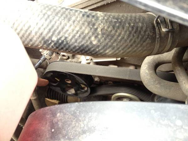

    So my truck just started making a loud whine today. The higher the RPM's the louder the whine, whether driving or parked. From what I read this can be a problem after taking it in some deep water or mud, and yes i took it for a dip in a reservoir last weekend, deep enough as to where it started pouring in the passenger side. I noticed some grease or oil around one of the pulleys. Just wondering what you all thought the culprit might be. And will I screw anything up worst than it is if I drive it or should I wait till I get the part to drive it?

    Did the ol hose to the ear trick and I believe it's the no. 2 idle pulley closest to the passenger side, going to pick up a new one at napa tomorrow. Thank you tacomaworld!!

    It was the idle pulley, hooray for no more whine!
