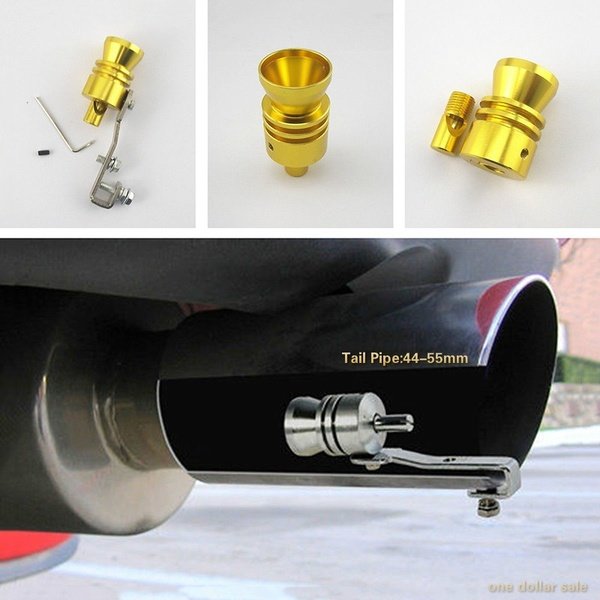

    It's a long shot but check the tailpipe for one of these...
    joshuajayg and Jimmyh like this.

    :rofl:
