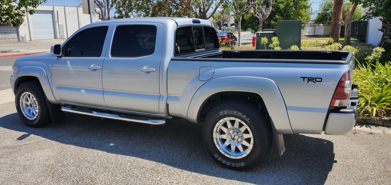

    Turns out it's already done by Johnny Mechanic. First time in my life I ever paid anybody to work on my vehicle except for a timing belt on my Honda and wheel alignments. They pulleys were in bad shape so they were all replaced. The belt wasn't cracked but it was quite brown and very dry.

    Nice looking truck.

    Truck’s in great shape and assuming the repair is sound I think it is worth it. Nice!

    Just popped in to say that’s one nice looking truck. Glad you got the issue(s) fixed. I suspect the dealership would have charged you twice what you wound up paying the mechanic.
