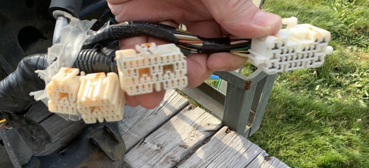

    I bought a 2000 ext cab 5vzfe 4wd with a 5 speed, trying to find out if the part number (82121 3D502a) I have is for the engine wire harness is a common one or if it matters and there are other engine wire harnesses with different part number that are compatible, like one from a 97 model year with the same specs.
    This truck has a factory installed supercharger, not sure if that made a difference, doesn’t seem like it would. Do like power windows, doors etc make a difference?
    The issue I’ve got is the plug ends that go inside the cab to the ecu (there are 3 plugs total at the cab end) are brittle from the truck sitting out in the weather for a long time.
    It’s possible they sell just the plug end but haven’t found info on that either.

    Only thing I see that’s wrong at this point is the release clips on the plugs are brittle and a couple have cracked.
    I see the issue being if I treat this new truck like I do my current it’s going to see rough terrain at moderate speeds so there will be vibration and if those clips aren’t going to hold I’ll have significant problems so the main thing I want to do is change out those plugs.

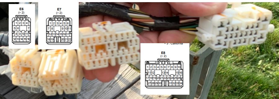

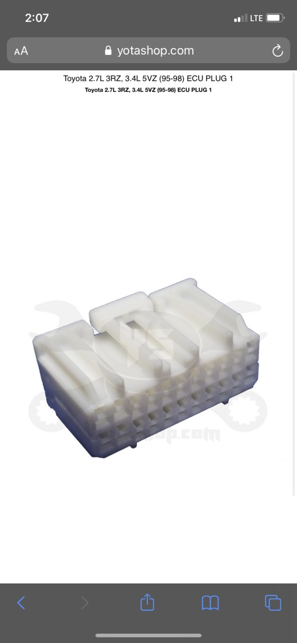

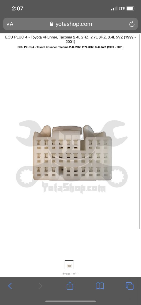

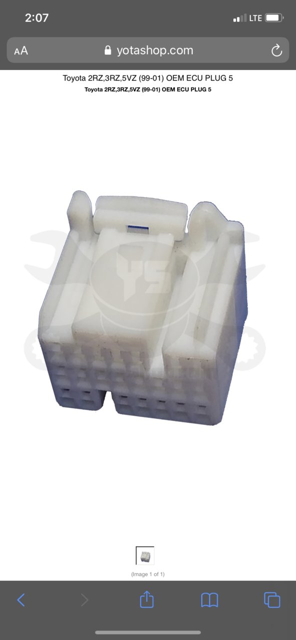

    I researched a bit and think I found something at a local shop that supplies a lot of oem parts. C8B9B17E-BEC7-4400-B520-6B9088024E61.jpg450D57F6-15FA-404E-A491-510F363551BE.jpgF49DB701-20C8-498C-84E4-3324205CD044.jpg I’ve compared these to the plug ends the existing harness has and there are subtle differences, so not sure they’re an exact fit, but Yotashop been a good resource in the past so hoping they’re a match.
    It seems like a heavy handed solution to depin and reconnect the new plugs just because the current plug ends are brittle, but I’m planning on going through this engine and the supercharger thoroughly because it’s sat for a few years according to the guy I bought it off

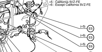

    4D71556A-9AF2-46CA-9EBF-75C213E4174A.jpgThey look nothing alike

    The one on the right, I can't seem to find a match. I will update if I do. These are from a 2000 5vzfe.

    @caribe makaira do you have 1st Gen specs too?
    OP, for sure de-pin and re-pin. Practice on your spare. Small screwdriver or de-pinning tool or caribe likes leather hole punches. Sounds like all you need are a few connectors. Take photos and then draw up a diagram with graph paper and crayons for the colors.
    One connector at a time and test everything in between for a week or two.

    You used to be able to buy the plugs from Toyota but the age is going against you.
    Are you sure those Pictures are the real part from Yota Shop and not just a generic picture?
    With Trucks this old surprises in parts are not uncommon get the part # from your ECM and see what year that is and go from there.

    I think these are all correct, but please look carefully. I don't know a source. Maybe someone else does.
