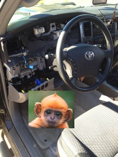

    I forgot to mention, I snapped this picture while I was at the dealer earlier today:

    Unreal. It's hard to believe the dash has to come apart like that for a problem like this. I was thinking fuse, solenoid, relay (all under the hood)...etc
    I'm dying to know what they come up with as the problem..... and the price! Good luck Chad.

    09 V6 Access Cab TRD Sport
    Kenwood DMX-7704S Headunit -- Blackvue DR-470 Dashcam -- Pioneer TS-A1685R Speakers in Front -- Suntek CXP 40 Front Tint -- Access Vanish Roll-up Tonneau -- Wet Okole Seat Covers -- Fog Lights on Anytime -- PnL Powered Tailgate Lock -- DTRL "Stealth Mode" -- LED Footwell and Cup Holder Lights -- Map Lights ON with Dome Light -- Shorty Antenna -- AC Line Extension Mod -- Access Cab Rear Headrest Removal
    They've said the problem was a relay, specifically the relay that deals with the engine immobilizer. I find it incredibly odd that the WHOLE dash and center console needed to be ripped out to figure out the problem was really in the engine bay fuse box. My only explanation I could come up with for that was they needed to check some voltages on some wires that are involved in that process behind the dash to see if that was the issue.
    For some reason they didn't have any of these specific relays lying around the dealership and had to order one. Had they had one I would have had them put it in and I would put together my dash and console myself.
    PS: I should have taken a picture of it while I was there. It really was amazing to see how much they had dismantled.

    Isnt that a 4runner interior?
